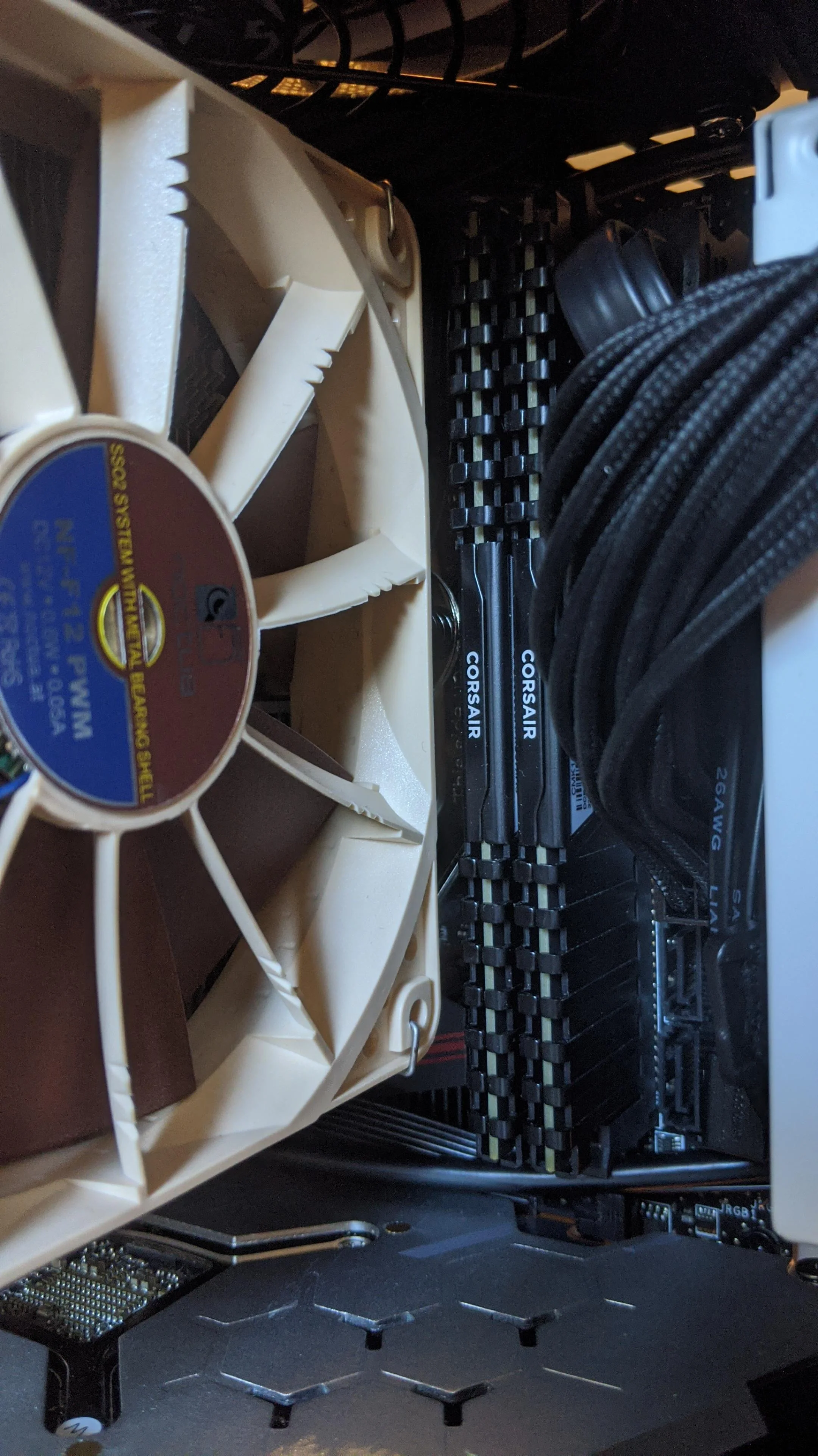

Received the case on Monday but hadnt yet recieved my nvme drive so I had a thicc 3.5 incher which made cable management a bit messy, managed to clean up the cable clutter okayish before I got bored of it.
If you want to mount 2x 25mm thick fans under the Nitro 5700xt it's a suuuuuper tight fit since the card is thicc at . Due to gpu sag the gpu fans were clashing with the bottom intake fans, to solve this I had to add a 30mm spacer which you can see right next to the right most bottom mounted fan. This all turned out to be completely necessary since the bottom intake fans were barely doing anything at all to lower gpu temps :) Am very curious though to try and deshroud the gpu and smack the p12s straight to the heatsink and run them as exhaust.
As for the actual temps I had my doubts about how much the extra 2 bottom mounted arctic p12 (intake) were actually doing for overall gpu temps. Turns out they arent doing **** basically and furthermore since the gpu is so damn long the backplate of the gpu basically blocks all fresh air from the bottom mounted fans to reach the cpu. As for the actual gpus temps, the GPU is running at slighlt undervolt at 1090ma/1999mhz and fans set to max 45% rpm. I tried to rounds of Heaven Benchmark. Both GPU and GPU hotspot was on average 1-2c lower when using 2x arctic p12 @ 50% / 1000rpm, in other words, not even worth it.
Specs:
  • Ryzen 3600
  • Noctua NH-12US with an extra Arctic p12 fan, both as intake
  • 16gb ram
  • Shappire Nitro+ Corsair sf 750w
  • 1x 500gb samsung evo 860 SSD
  • 1x Kingston A2000 1Tb NVME
  • 2x Arctic P12 as top exhaust
  • 2x Arctic P12 as bottom intake
Temps
  • Ambient: 22c
  • CPU idle: 40c
  • CPU Cinebench R20: 73c
  • GPU idle: 37c
  • GPU Heaven Benchmark: 65c and 84c hotspot
Idle temps may seem a bit high but thats on purpose since the computer is basically whisper quite when not playing games, which is amazing since I can work in altium/kicad with my projects without the computer noise driving me crazy.
Also some user asked about cpu cooler and memory clearence, cant remember who but here is a bonus pic, plenty of space :D
