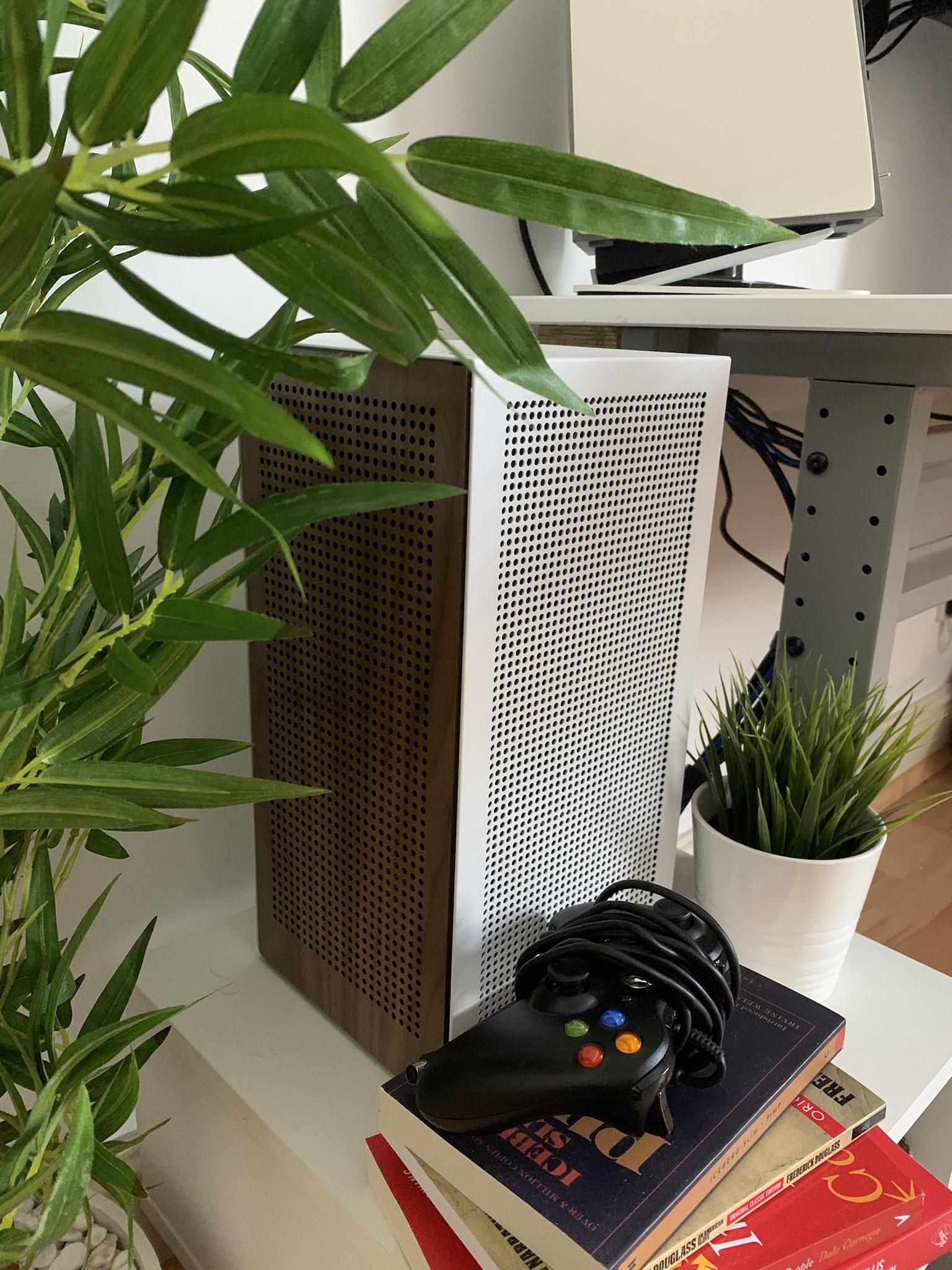

Wow, just doing some testing with the new vented front panel.
Temperatures are down around 7-8C but omg, my PC is so much quieter now. You can really feel the heat coming out.
Finally put on my new aluminium powder coated front panel. Loving it so far. The ventilation cutouts align nicely with the rest of the case. Drops 5 degrees in peak temperatures when running Timespy with fixed fan speed (5700xt).
