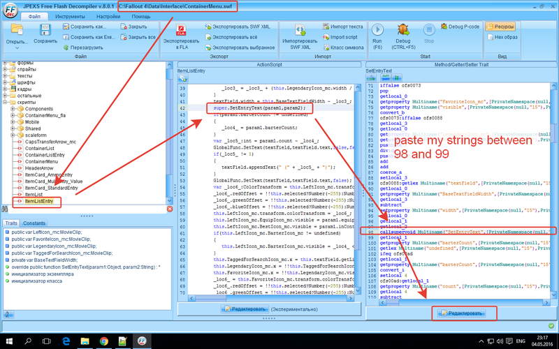

First you have to download the JPEXS Free Flash Decompiler, then just do as explained in the spoiler, which being used due to the pictures.
Go to your Steam Folder, then Fallout 4 / Data / Interface and then open the ContainerMenu.swf in JPWXS, find the below:
Example1ByNeanka_zpsygekd9cg.png~original
Once you follwed the picture instructions, copy and paste this after Line 98 callsupervoid Multiname("SetEntryText"...

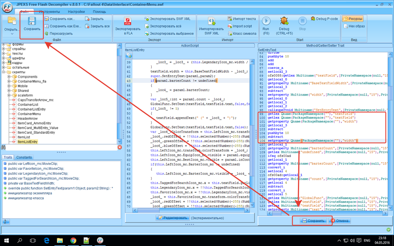

After that should look like this then save it:
Example2ByNeanka_zpsvhavfcsy.png~original
Then do the exact same with your BarterMenu.swf and that's it !
