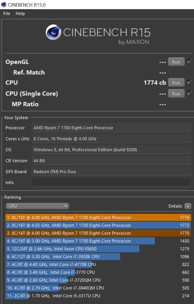

I am now I've overclocked via the P State 0. Here's the difference in performance in Cinebench between the two modes.
Balanced
High Performance
High Performance is a little bit faster, so if you want absolute performance or are benching, this is the way to go.

Yes i posted the same screenshot twice, I'll see if i still have it saved but it may be lost. Essentially performance mode was offering around 20 points more than balanced mode when overclocking the P 0 State.
