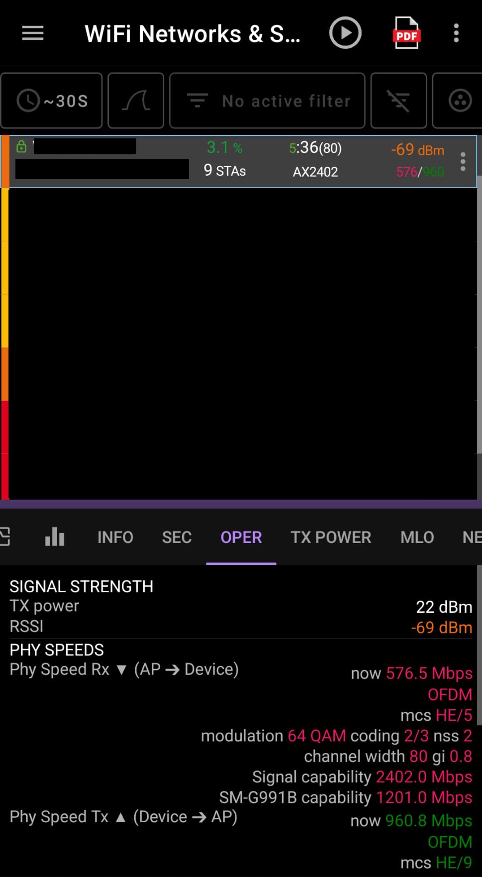

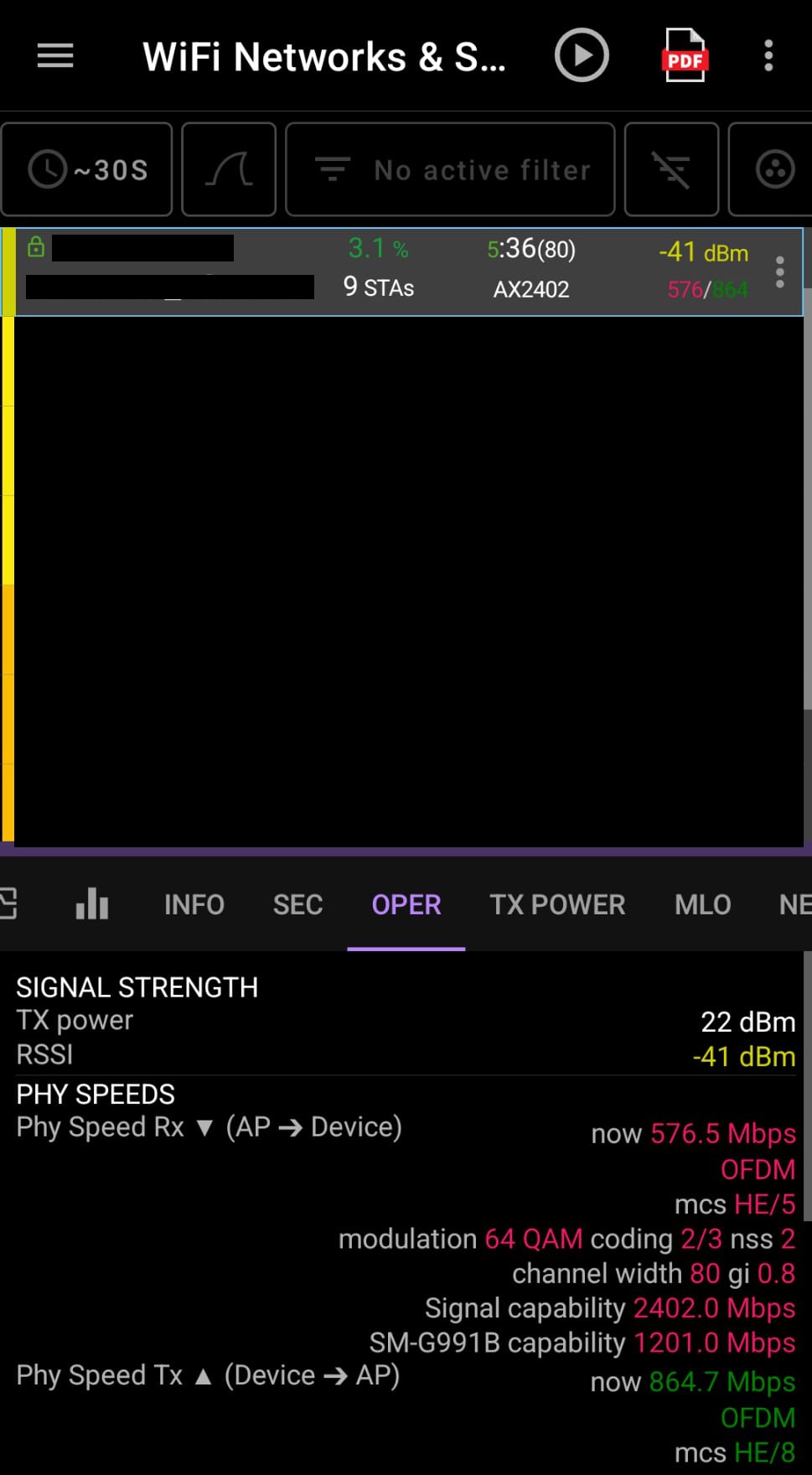

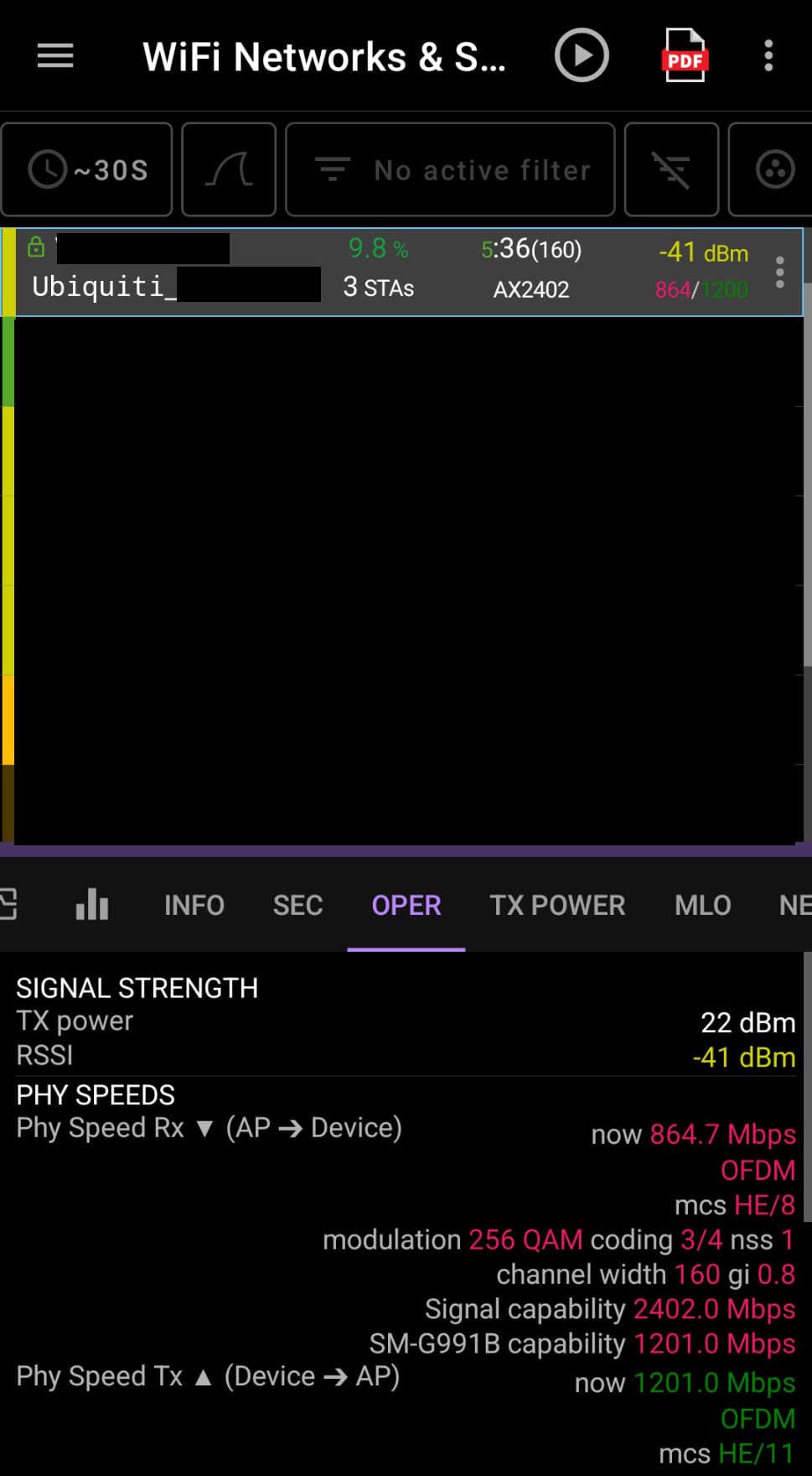

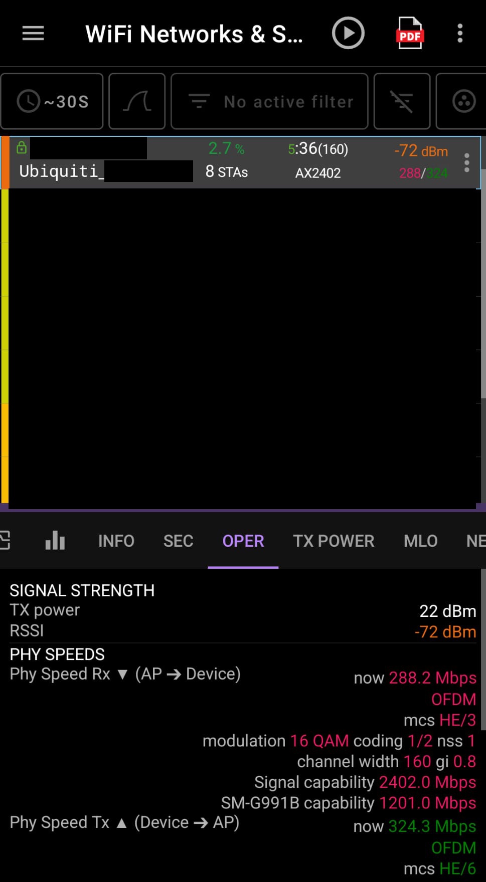

What client devices do you have? Do you have an Android Phone?
If so, download Analiti and take a look under the OPER and see what it says for PHY Speeds, or better yet upload a screenshot here.
