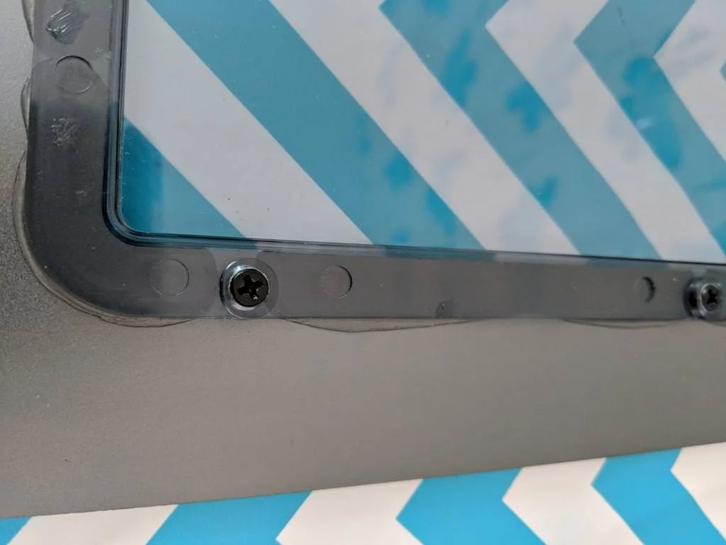

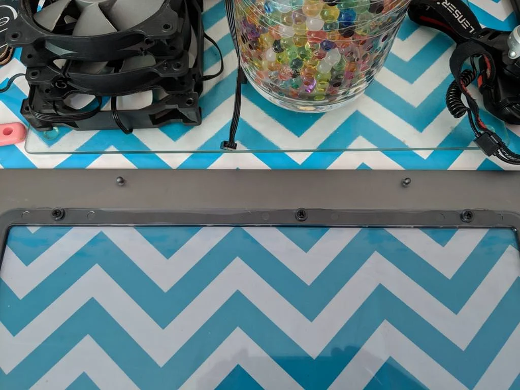

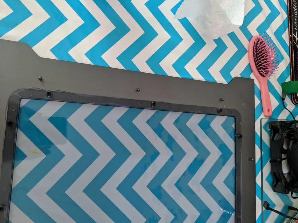

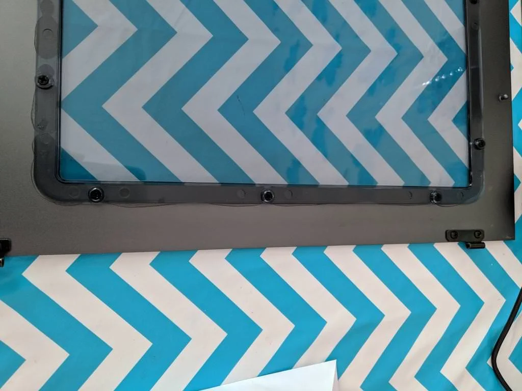

Well today I unscrewed the screws holding the perspex in the door and took the perspex out. I put the door back on and no vibration.
Tomorrow I'm going to put a small bead of silicone (clear) around where the perspex sits in the door and let that go off, see if that helps.
I can't leave the door off, the blue LED's are blinding me lol :cool::cool::D
Well I added the silicone and it certainly helps.
I think they should have added more screw points to secure the perspex better.
When I took the perspex out and lay it down on a flat surface to apply the silicone I noticed it was not flat and very twisted. See how it goes in the next few weeks. Definitely better for the time being.
When the silicone has gone off I will go round the inside with a Stanley blade and cut the splurge off. There is a lip on the other side which was nice as it stopped the silicone coming out on the front side of the panel.
