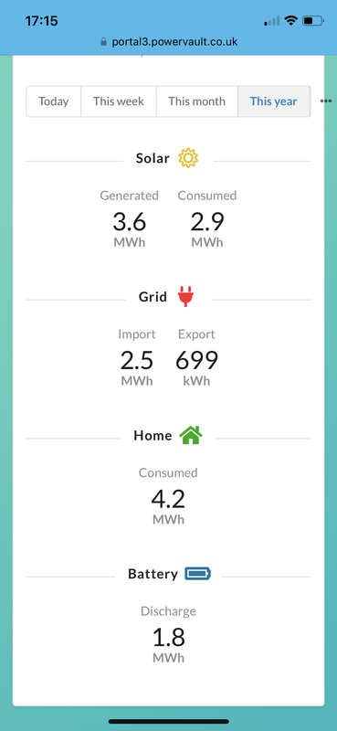

We don’t have a smart meter so our “estimates” from EDF seem to vary.
The best I can do is my Battery Portal which gives totals but they seem to over read a little bit and doesn’t read to the kw. We only have electricity so no gas.
