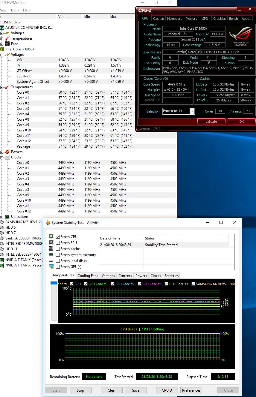

I'm happy with that... 4.5GHz at 1.35v - over two hours of AIDA64 and also tested AVX instructions with handbrake
Is there a reason you didn't test with CPU, FPU, Cache and Sys Memory checked?
AIDA FPU should ideally be run on it's own. It's AVX2 routines can pull quite a bit of current through the CPU, especially when ran in conjunction with the other tests.
It's obviously better to run the CPU, cache and memory at the same time, although AIDA cache routines are great for isolating that sub system. So for pushing cache, I'd recommend testing with that, and also HCI Memtest for testing memory and cache at the interaction level.

Nope, just standard order... Looks like I won the silicon lottery as like you mention... They don't tend to clock this high, let alone with a relatively low voltage.
I've read reviewers struggling to hit 4.3 @ 1.4v
So rather happy with this cpu... Already had someone offer to buy it from me... But it's have to be a decent offer to snap this off me :)

Although I probably wouldn't notice any real-world difference between 4.3-4.4 & 4.5GHz.
