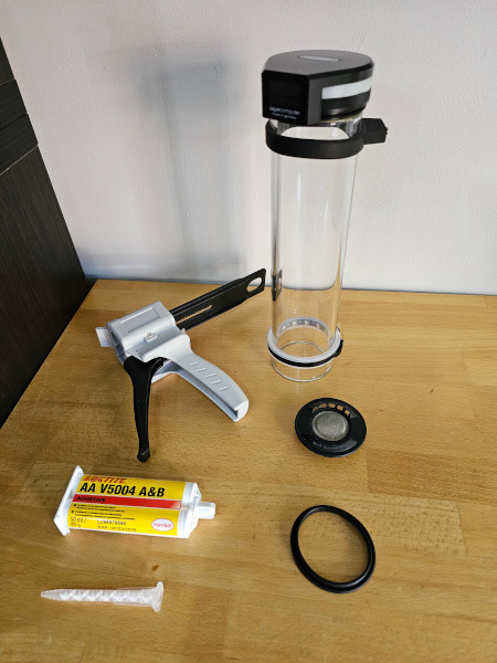

Right, couriers have been and now I have this lot:
From bottom left going clockwise:
  • Nozzle for glue
  • glue
  • dispenser gun for glue
  • 65mm diameter borosilicate glass wearing
    • an RGBpx ring - might use this for lighting it, might be able to underlight it, not sure yet
    • tube support - might be able to bake this functionality into the top ring but it's another option while I'm getting an order in
    • LeakShield unit
  • Strainer for Ultitube (which this isn't but mimics)
  • Top seal for between tube and LeakShield
Started trying to sort out the design now I have physical things to measure. The tube of course varies and isn't perfectly round. It's not bad though so we'll see if printing rings with a 0.2mm gap (which I've just realised I should have doubled *facepalm*) will fit. Already discovered that my dimensions for the strainer were way off as I thought it sat IN the tube but actually it's essentially the o-ring for the bottom of the tube. I'm just trying to work out what the thread is between the LeakShield and the Ultitube ring. Not really enough threads to measure well but it's either M68½ x 1.5 (!) or 2¾" 20 tpi with a 60° (UN) angle. Neither of these seem exactly likely so I've asked on the AC forums but naturally I've managed to time it for about Beer O'Clock (in Germany) on a Friday...so I'm not likely to get an answer before Monday. Surprisingly, the UN thread is actually available in Fusion so I might just give that a go and see if it works!
