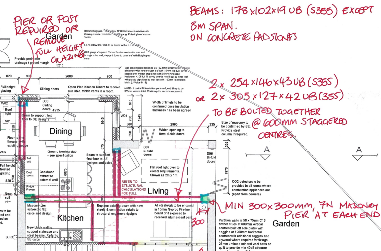

Looks great, that’s going to be a huge steel supporting the original upstairs of the house. Just bare in mind that you may get cracking for settlement upstairs when they remove the strkngboys / acrow props
I have over 130 pages of calculations such as stress loading etc; here was the overview part i think you are reffering to.
Are you getting the structural steelwork put into the ceiling so you don't have the "bulkhead" in your room reducing ceiling height? That's what I'd do if you can!
Got quite a lot of steelwork in my house and much neater where it is /can be hidden.
To give you a flavour, the big steel (if it ends up being the larger size) will be 305mm height and approx 300wide which is pretty chunky. Google will tell you the steel dimensions if you're not familiar.
Edit: whoops I realise I asked this before! Any updates on the builders proposal?
The plan is to try and get a lot of the steelwork lifted (if possible). However, in some cases it can look like a feature of the room. It is going to be reviewed as we go along.
I love the way architects never draw the piers in for the steels to sit on, almost like they think they levitate seamlessly next to the wall ....... :cry:
100% agree with this.
I advised someone else on here to keep it as a feature, have it painted intumescent paint with a top coat of your finished colour choice. Building Control should be happy with that as long as it has the correct fire rating (we needed 30mins but I coated it a second time to give it 60mins protection).
Then install an LED strips on the bottom flange near the root radius firing upwards. You'll have a great effect and won't need loads of awful spotlights. LED strip with 14.4W/m output worked well, plus I used 3000k as warm white gives a great warming effect. 4000K could also work if you like the daylight look.
