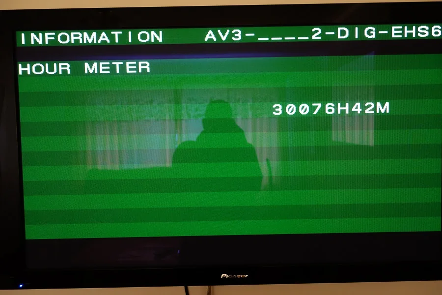

My 2 plasma's are 11 & 12 years old (the 12 year old one had over 30,000 hours on the hour meter and is still working fine)
Wonder if my 65AF9 will last this long
This was taken a long time ago
plasmas were rated to last 100,000 hours before brightness halved. so 30K is nothing really.
