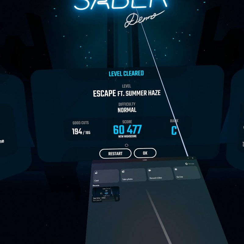

Damn, this beat saber is addictive! I've just had a few more goes on the free demo and am just one good cut from perfect.Seems hard to get that last cut and I'm only on normal difficulty! I bet there's some experts here who have beaten the most chaotic levels. I learnt how to take an ingame screenshot.
