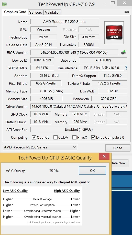

Do you think the core voltage would go any lower and where do I find out the card's asic?

GPU-Z will let you read the Asic. Right click the titlebar of GPU-Z and select read asic.
