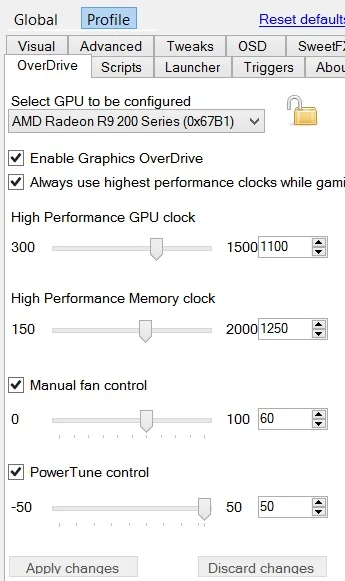

Interested in this also for example when playing Wolfenstien my FPS is capped at 60 even though V Sync is turned off and GPU usage fluctuates and only runs a varied core clocks temps don't exceed 62 degree's compared to Crysis 70/80c.
Is this a driver issue or how the game is setup? The concern is that sometimes my FPS dips and the core clock dosen't go higher to its full potential to counter that.

Try raising the fps cap, or you can use this as an alternative solution for the core clock fluctuating.
Try this for a fix for the clock dropping. No need to use unofficial overclocking method either so clocks will drop to 2d levels as normal.
1. Download RadeoPro - http://www.radeonpro.info/2013/11/new-build-with-support-for-amd-radeon-r-series/
2. Create a profile using the game exe.
3. Click the profile tab, then the overdrive tab. Click the padlock to unlock overdrive, click enable graphics overdrive, then click 'always use highest performance clocks while gaming'. Don't forget to set +50% power tune in RP. Now right click the game profile shortcut on the left and select apply then launch the game.
