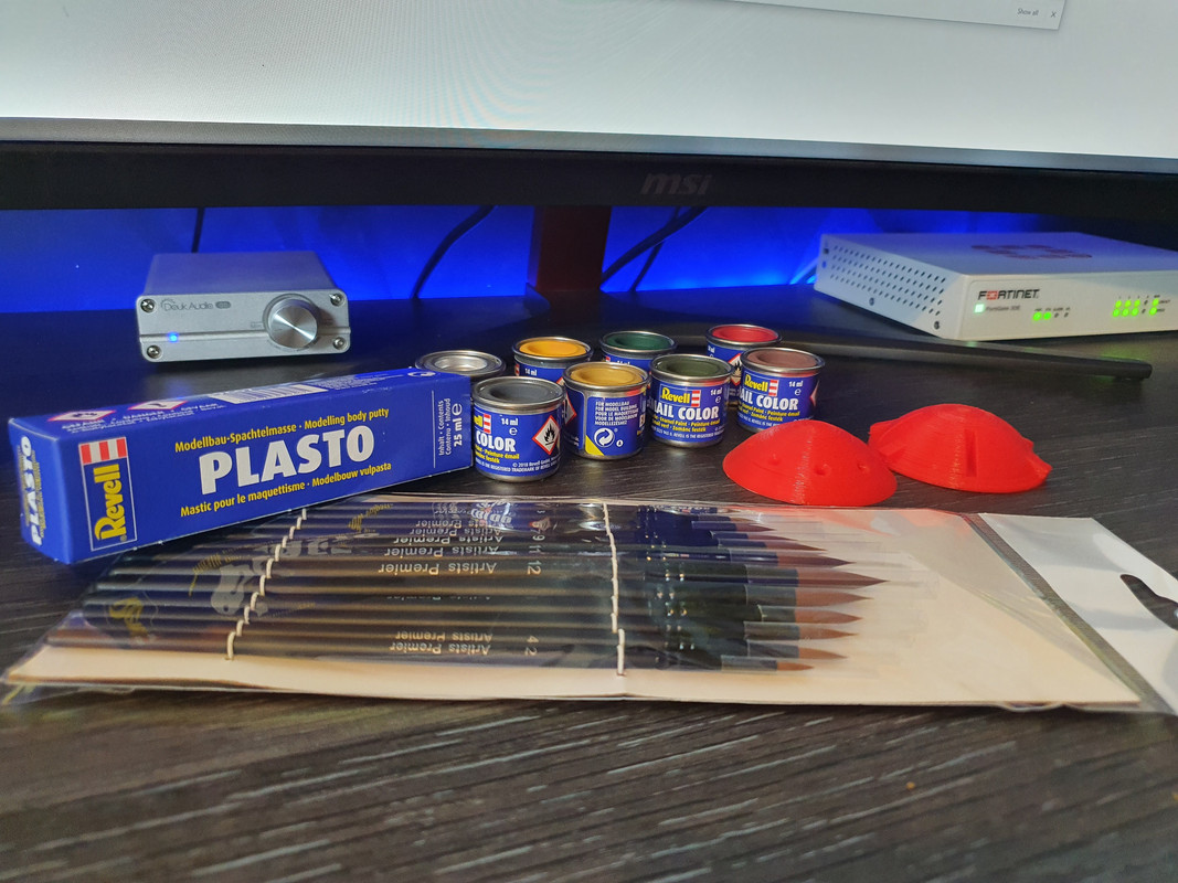

Is it a Fat Man missile and/or launcher from Fallout? Took me a minute if so!

It is a mini nuke :) Thought I would build me a mini nuke model. Had to do a load of repairs on the cheap china 75 quid printer last night and thats printing now so shall hopefully get around to messing with the big boy this weekend :D
