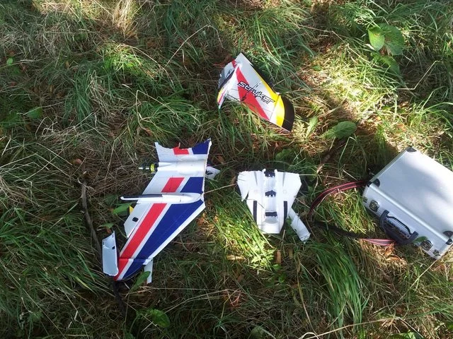

Now, can anyone spec my a kit for my Stryker F27Q electronics? I flew it through a tree this morning and it's beyond repair. It'll cost me £85 to fix it, but the whole plane only cost me £110 delivered brand new so I want to try something different with the bits I have that still work.
Here's a pic for those that want to see the carnage once I'd found all the bits.
At least it was all on the floor and I didn't have to climb a tree.
Makes me sad to see broken RC planes :'(
