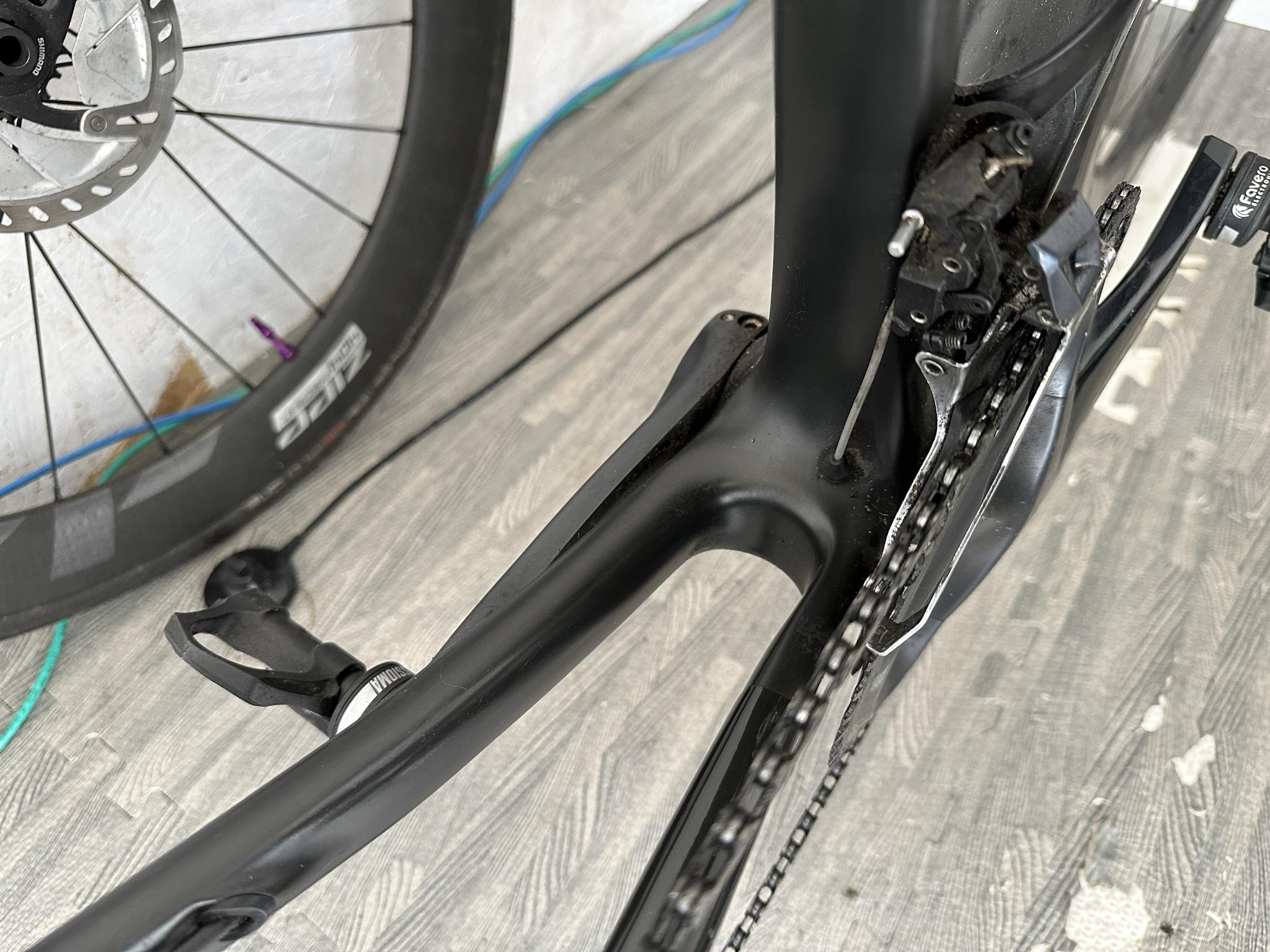

Found this image on the Canyon site. Really, I guess as long as there is enough of a void between the frame and the bottom bracket housing, I should be able to have the cable go down the seat tube and back up through this part here....
Though I expect i'm going to have to find a solution to block the holes back up as I doubt the DI2 connector would pass through the rubber? Or maybe a very careful cut with a blade
Di2 connection should pass through there fine. Little surprised it doesn't have another port higher up off the seattube.
