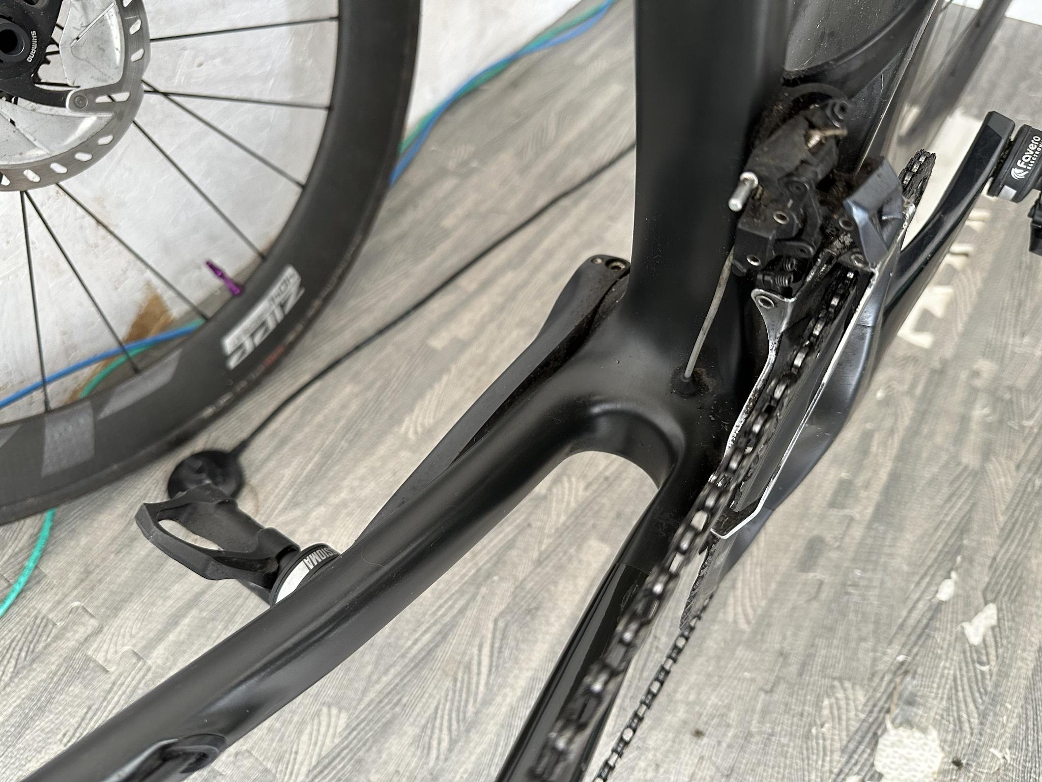

I should be able to have the cable go down the seat tube and back up through this part here....
Though I expect i'm going to have to find a solution to block the holes back up as I doubt the DI2 connector would pass through the rubber? Or maybe a very careful cut with a blade
You'll likely find that rubber grommet comes out. It might have a split on the side so you can slide it over a cable, then push it into the frame. Just be aware before you try to yank it off, it may have a collar or some kind under it, so removes from below (which you'll only be able to do with your BB removed), likely just pulls out the top so make changing the cable easy, but it is a Canyon so might not be logical. At least there will be diagrams for it - your one above looks like it just pushes in but there could be a difference between the electronic & mechanical ones.
Di2 cables (certainly SD50) are made 'cable width' with the plugs being 'outer width' so they should fit through frame holes. SD300 is smaller, but you couldn't push it through that grommet without taking it out the frame first. Hopefully it just pushes out and has a split on it, so you can just wrap it around your cable and then push it back in. I'll take a picture of what I did with mine.

I'll be genuinely impressed if you **** up the cable routing. The battery sits in the seatpost and 2 cables go from there to the FD/RD. Both take the only path possible. Its honestly super easy. I rebuilt an entire bike in an afternoon with 12 speed di2 and thats inc. the faff with bleeding disc brakes etc.
Yup, just wang the cables in.
Reminds me, fairly sure I've got a 1200mm one in my downtube when it only needed to be 800. Just shoved it in. Not even sure I fitted any of those black zip tie like things to stop it moving. Not heard enough of a rattle from it to remind me...!
