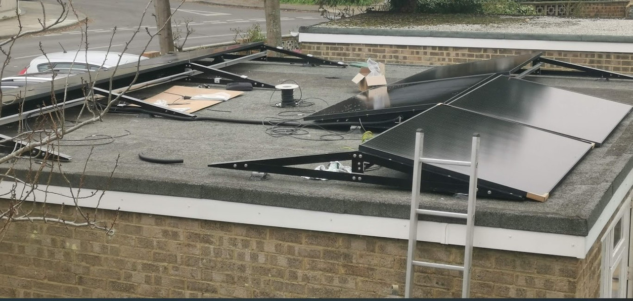

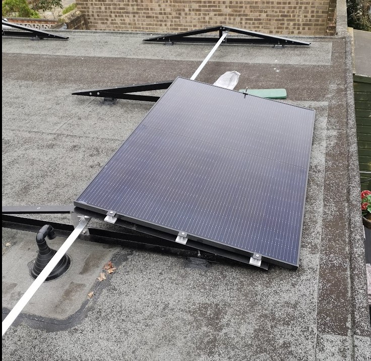

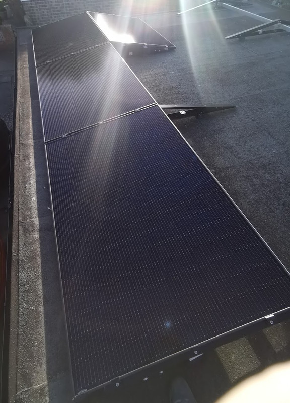

Have you actually left him anything to do? Gonna be his easiest visit of the week.News Flash
Electrician is booked for 21 & 22 of this month, so that gives me two weekends to get things ready, don't think there is much actually left to do.
Have you actually left him anything to do? Gonna be his easiest visit of the week.![]()
I think @katie279 has sent some birds down to poop on the panels already!
