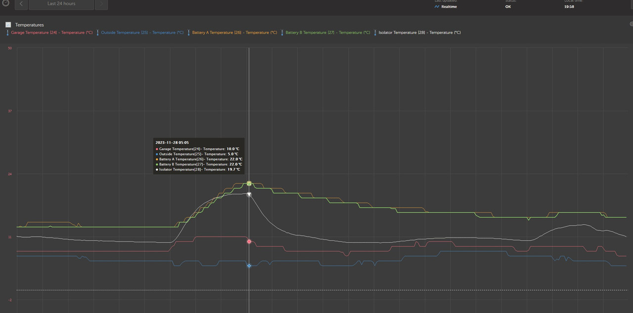

I now have my heating system fully connected up, and the Cerbo will turn it on if/when the batteries get down to 8°C and turn it off at 12°C.

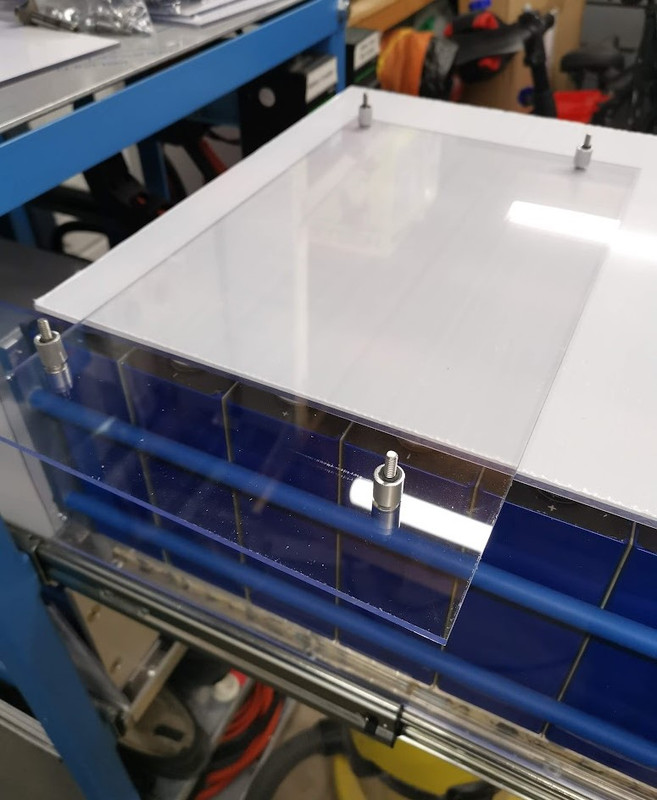

I've also now have my functional incubators, made from polycarbonate. I've basically got four sides, which bolt to the aluminium end plates, and a top, so each battery is enclosed. I've bolted three sides on both batteries, still need to make the mounts for the fourth side on each.
This is the only picture I have at the moment, its one of the end plates.
They certainly appear to retain the heat for longer, if its still not enough I'll have to wrap them in a fire blanket.
The last 24 hours temperatures. The orange and green line is the two batteries, the white line is a temperature sensor thats on an isolator that gets a bit warm - you can see how quick that drops off compared to the batteries.
