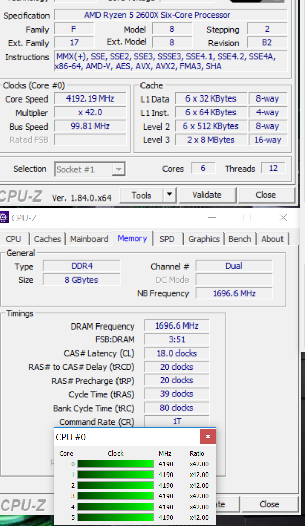

in my testing 3600 has been very hard to hit, pretty much just as hard as it was on the 1700x
3400 seems fairly easy though using teamgroup xtreem 3866 memory that I've had up at 4100 MHz on intel and managed 3733 for a screen shot on ryzen

Is that on an X370 or X470?
this is on the CH7 but the results were the same on CH6
I managed 4.3 on all cores at a similar voltage to what others leaked on the CH6, ryzen master might finally be working so i can have a proper play
So far i've tested the X470 ch6 and ch7 and the aurus gaming ultra unsurprisingly the ultra managed 4.225 across all 8 cores which given how much cheaper than teh cH7 it is is not bad.
3200 32gb (8x 4) cas 14 @ 1.35v was fine on all boards with the 2700x
