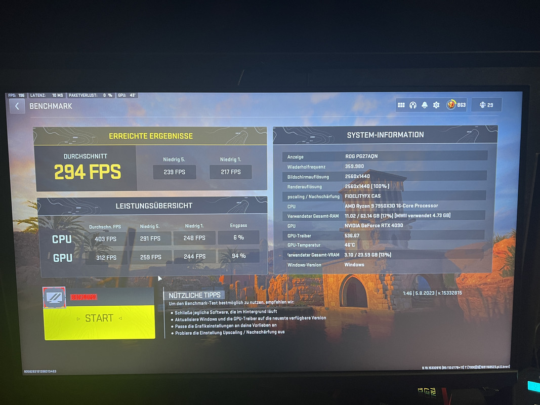

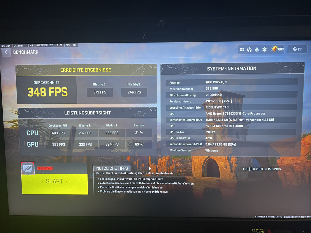

Your cpu is running fine. Don’t take much notice to others results that are much higher.Hello everyone, hope everyone is doing well and wish everyone a nice weekend.
I am very happy that I found this forum and hope that someone can help me. I have to say that I am not familiar with PCs & Co. at all.
I had a completely new PC built a few months ago. But unfortunately I'm very disappointed because it's not going really well. I'm currently only playing CoD MWII/WZ2 and I'm very dissatisfied with the FPS. And for that reason I hope someone can help me via discord or something like that to make my pc run really well. I put 2 pictures of the CoD benchmark in.
This is my result without ram tuning.
https://imgur.com/a/OJPYvyY
I would get exactly the same as your result without certain tricks to get higher numbers. It have nothing to do with your cpu running badly.
Certain things you can install to get a good bump in numbers. Things you can enable/disable etc.
And this result I’m getting is still low compared to Beefy Tech for example.
You will find people trying to make things look better than they are for 99.9% of users because without this the CPU won’t look as good, and many would not buy.
Also Y Cruncher for Curve Optimiser is not so great. Nothing works great. You can get leak from one core to the next which can greatly affect the core or the next core being unstable. And don’t forget to test idle stability because you can be YCruncher 12 hours stable and crash at desktop doing nothing. There is no test for this idle stability either.
Your ram tuning can affect your Curve Optimiser stability and your Curve optimiser can affect your ram stability.
All in all I think this CPU is a nightmare to tune for very little gains. Unless you using tricks.
Unless these people do proper testing openly on a system that is set up with just a clean install of windows and no tricks I would not believe anything.
I have tested this myself and have found so many people asking “why is mine not performing correctly?” The answer is simply yours is performing correctly. You have been looking at people results with stripped windows and countless other tricks to get higher numbers. What the vast majority will get is much lower when you use everyday windows snd 0 other tricks including modded power plans.
My only other thing I would say is to not listen about this process lasso for 7950x3d. It does not make performance better than using the correct way.
