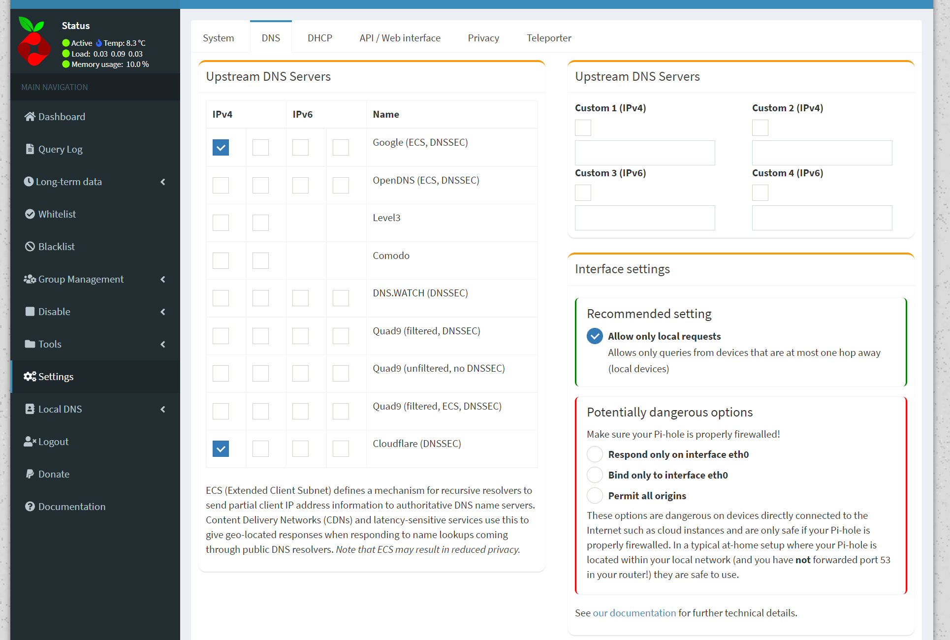

These are the DNS settings.
I think the fundamental issue is I can't ping the outside world from within the Docker container console.
I can ping the outside world from the Unraid console.
On this screen the tick box at the bottom should be unticked, then tick the next one.
This will set google as resolver1 and cloudflare as reoslver2 (for IP4).
Pihole usese a combination of 2 resolvers as (among other things) a load balancing measure. It will randomly choose to use your 2nd resolver even if the 1st one is fine.
The GUI above isnt very clear but column 1 is resolver 1 (which you have set twice) and column2 is resolver 2.
There are then also 2 resolvers for IPv6 and you have nothing set for either of those.
You can then further expand on this. by using the 4 boxes on the right to set your own resolvers.
Again 2 for IP4 and 2 for IP6.

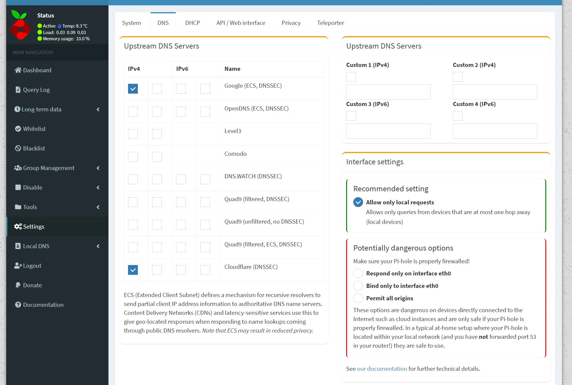

I agree with @MonkeyBasher - looks like the DNS settings within the application itself are set wrong. Here's mine as an example:
You also need to have the IP addresses for the DNS servers passed via the Docker container config - in my setup they are set to use the Cloudflare DNS servers:
I expect if you were to go to the Unraid Docker page, click on the menu for PiHole and instead of choosing 'WebUI' choose 'Console' and then try pinging something, that you would find you don't have a connection/can't resolve DNS outside your network.
