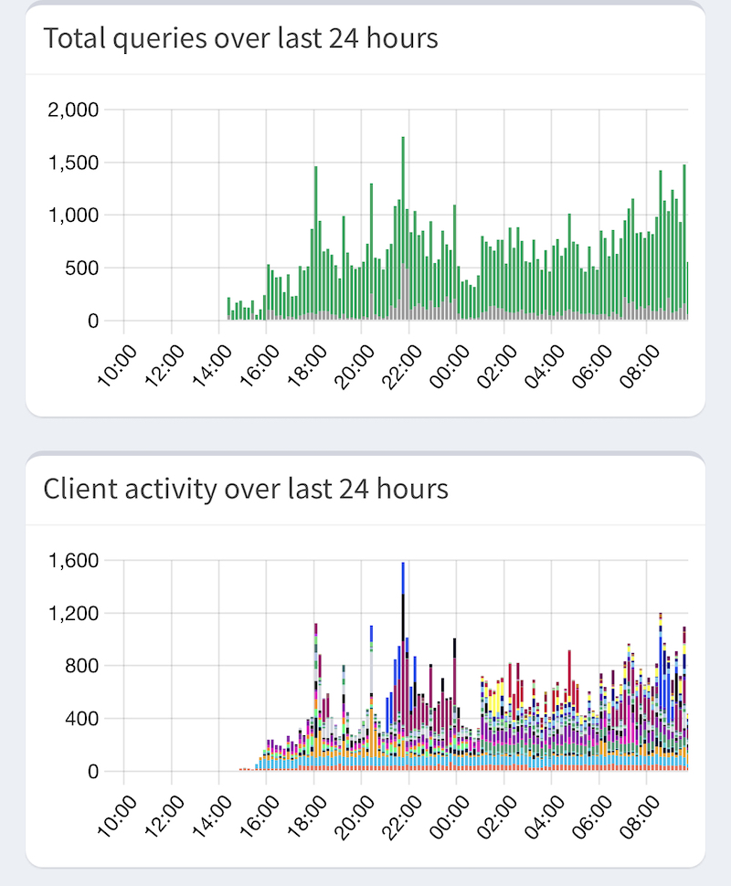

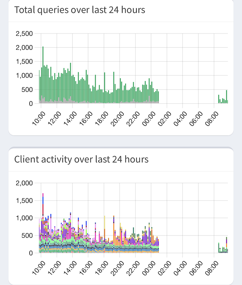

Where I made a mistake was by mistyping a - for an = in /etc/dnsmasq.d/02-pihole-dhcp.conf. I didn't restart the service after editing the file on pihole-bullseye1 so it didn't show up as a problem. At 01:00 in the morning, the file was replicated over to pihole-buster2 and the FTL service restarted. Because of the typo, the services I restart failed to restart leaving it effectively down.
You see where it all went a bit rubbish and then where I recovered it the next morning.
The new one did a splendid job though and everything continued working. This was a proper trial by fire, you can see I only got it online a few hours before.
