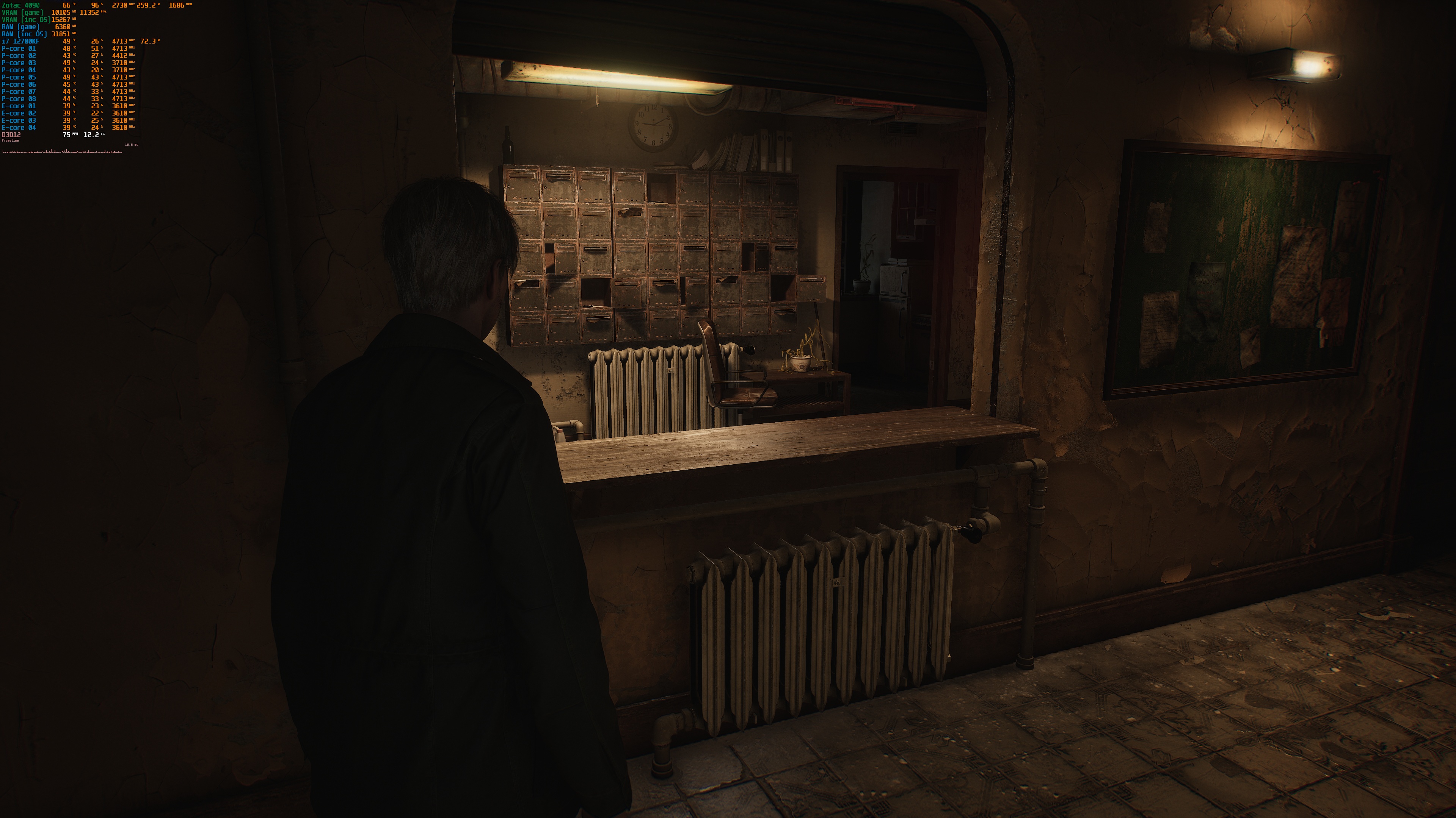

Wait until you get to Wood Side Apartments, the reception area especially for some reason has a whacked out frametime graph which results in lower framerates than anywhere else:
Also when you're well into the streets after doing the jukebox it seems to stutter a bit more during the windy bit.
I can tolerate these though as they are no the massive ones like we see on Jedi Survivor.

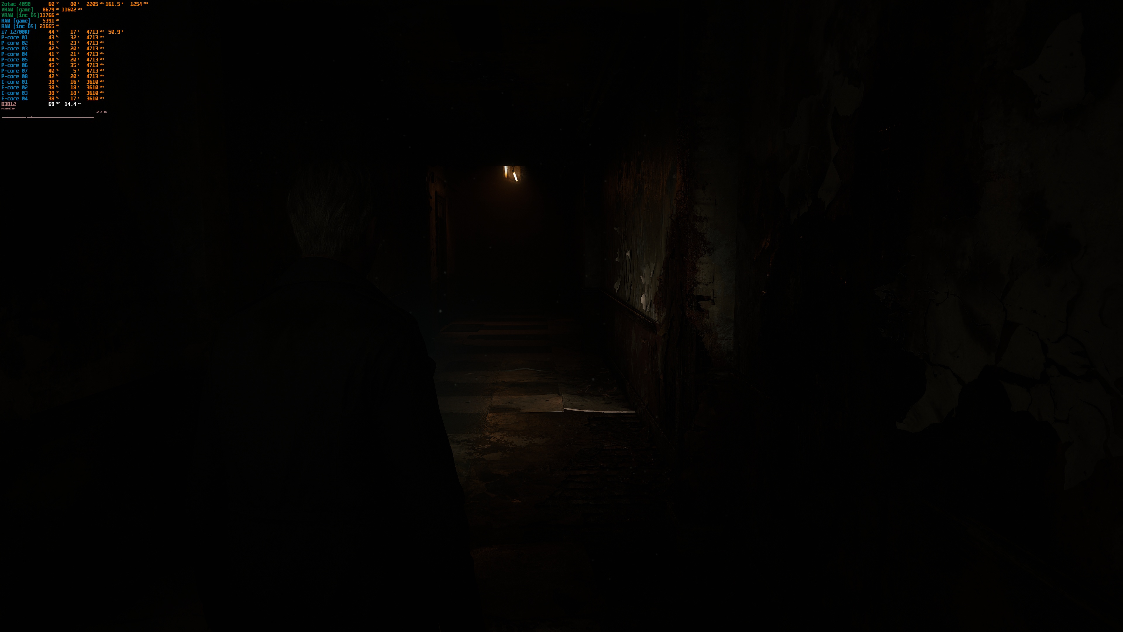

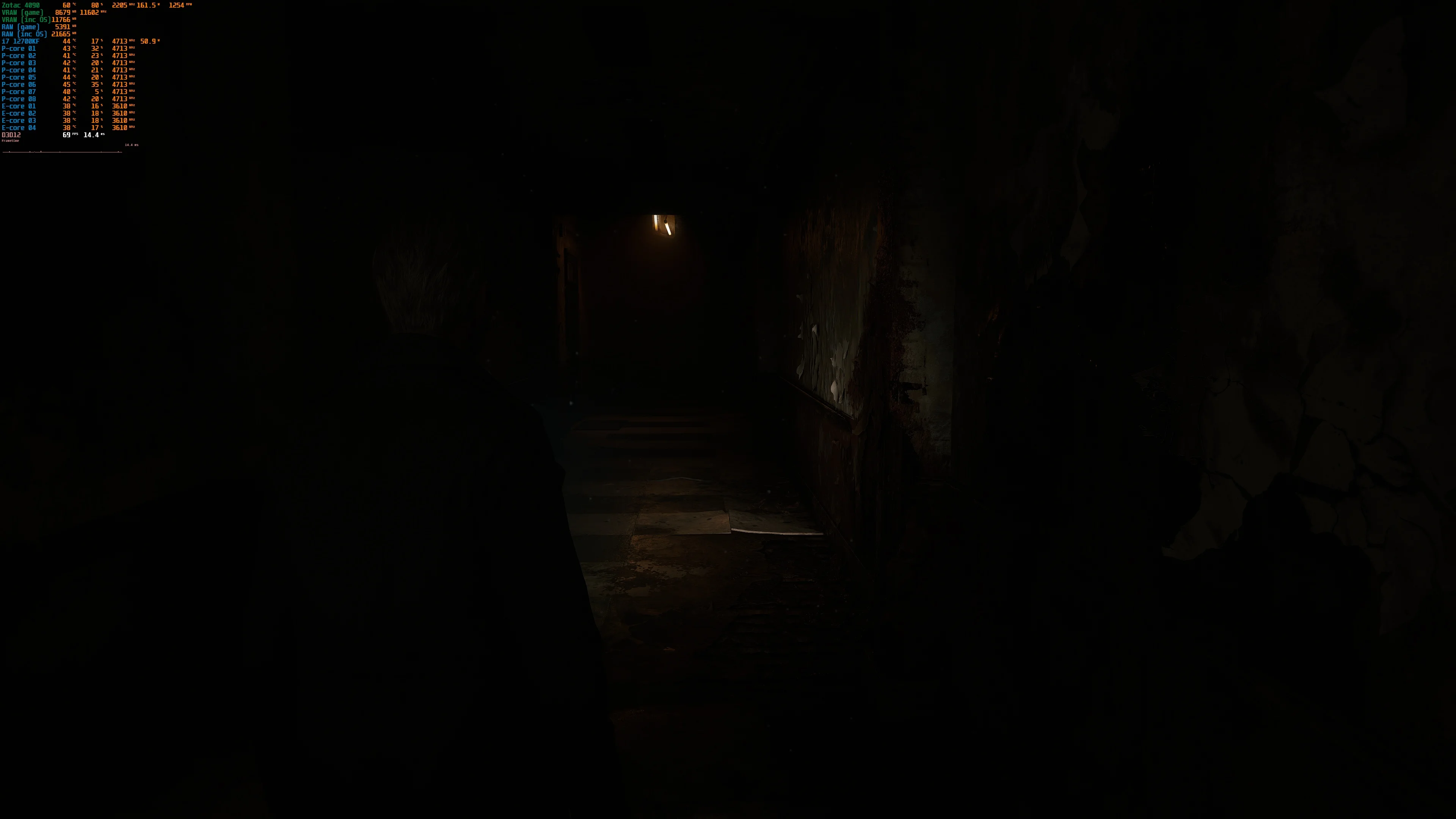

Look at this RTSS stat, the 4090 is at 80% utilisation, P core 07 is basically idle, and total CPU use is 17% meanwhile in other corridors earlier in the game it's 117fps with 97% GPU utilisation and all cores sharing the load..... Definitely CPU optimisation tomfoolery.
80% utilisation to draw the image above? Lol

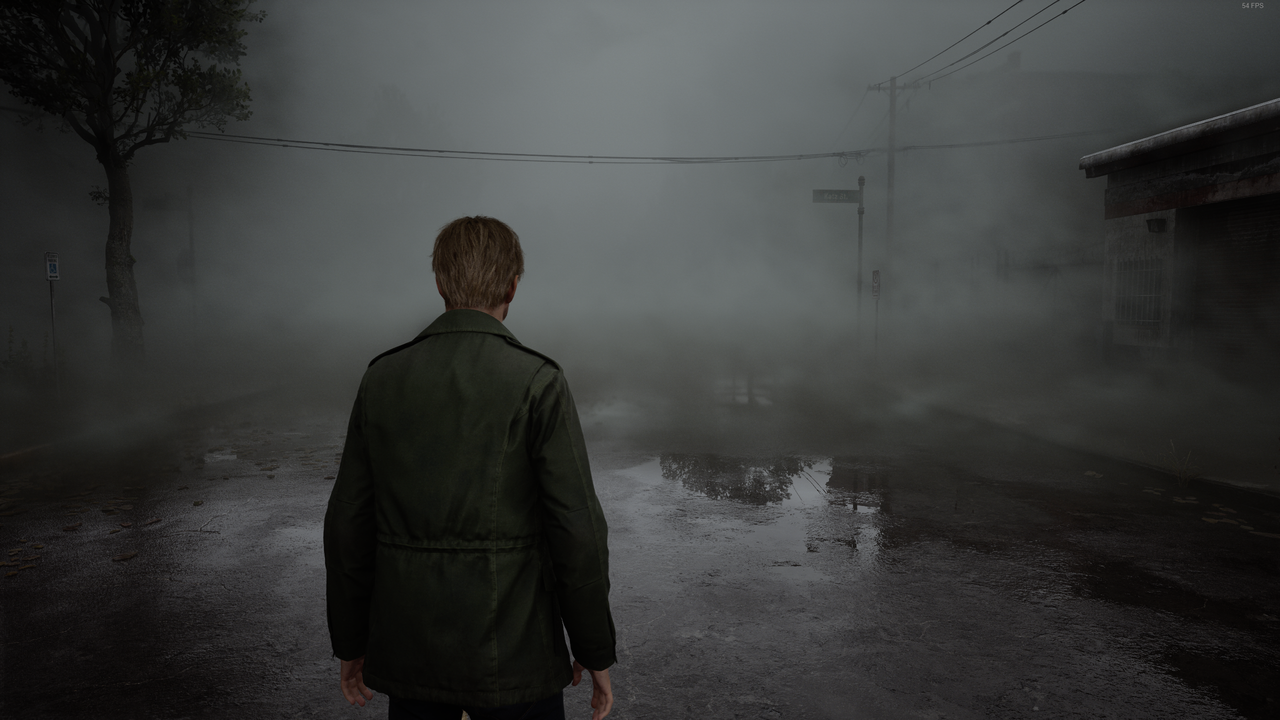

The fog looks fantastic but the one thing I've noticed messing around with settings and now can't unsee is that the reflections in the street puddles aren't correct even with RT, it looks like it's missing the fog layer?

There is a ./ini file tweak to enable fog reflections too, but ghosting is always there even with no upscaling, this is what UE5 does under certain game conditions in games like this with grey colour tones under contrasty subjects. The ghosting is not related to DLSS or FSR etc, it is simply there at engine level and one of the flaws with UE5 so not under control of Bloober.

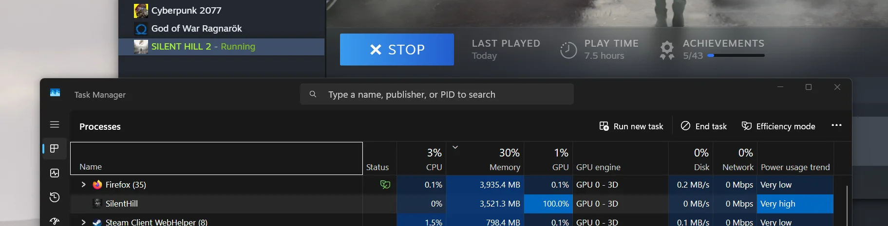

Hmm maybe I have found another issue, whereby the game does not exit properly and Steam shows it's still running even though seemingly it exited fine a few hours ago, looking at Task Manager I just spotted:
Had ot manually stop the game from Steam
