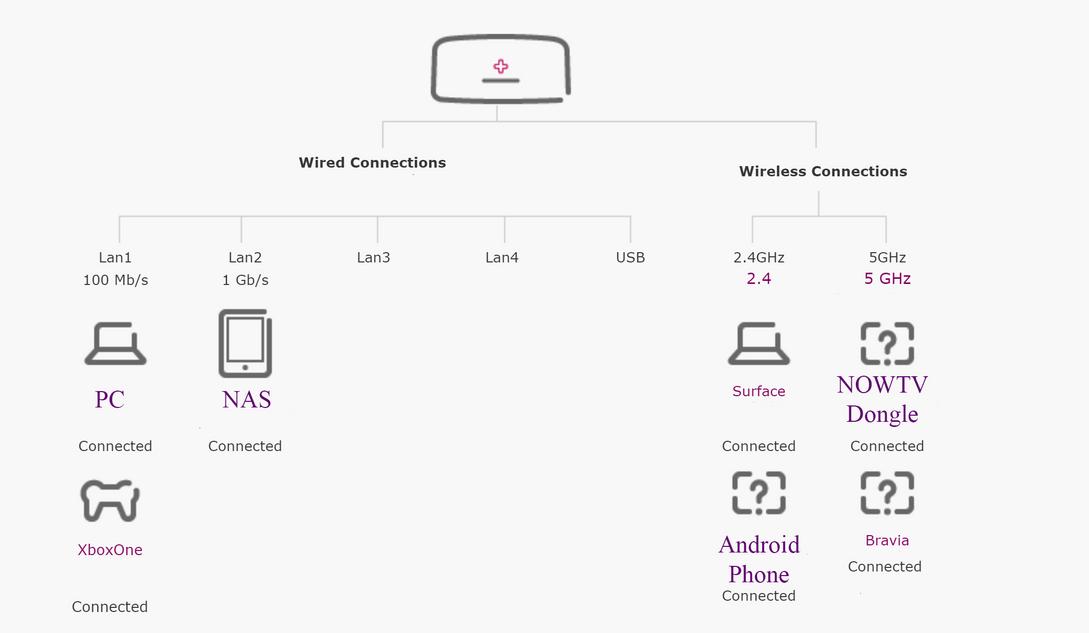

Here is how everything is setup.
It says the PC is only 100Mb/s and says the same when I look at the controllers settings in windows. The motherboard is a P6T Deluxe and should have dual gigabyte LAN.

I put in a new PCI Ethernet card and connected the CAT6a cable into the Plusnet Router and the network settings changed to a 1Gbps Full Duplex connection.
35MB/s upload speeds. That's just over a 3x improvement.
