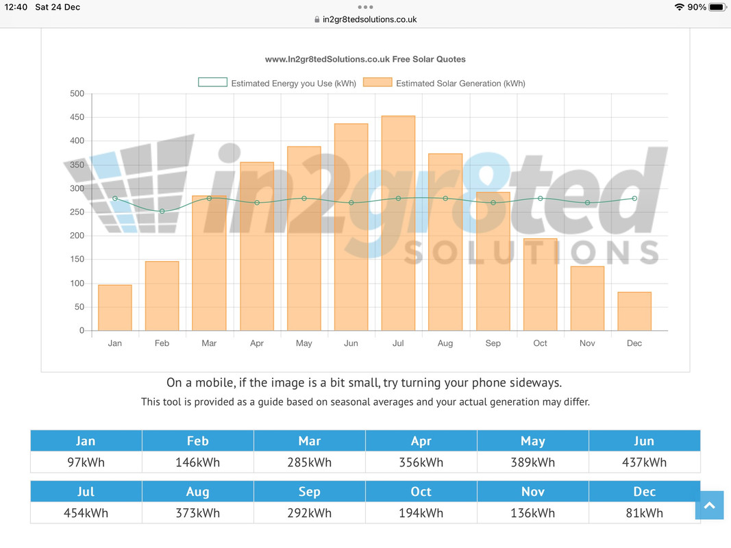

not when your getting good export and only paid 5k for the solar..........and your system is sized to suit your needs. on Tuesday we only imported 2.7kwh from the grid, which is 88p say. I exported 9.1kwhs @15p = £1.25. In the the longer sunnier days we could be exporting 20kwhs+ quite easily, so 3 bucks a day and paying out even less than 2.7kwh as the sun comes up earlier and the kettle, toaster etc etc will probably run mostly off solar and the early office use.Surely with such low usage your payback term for solar must be in to 20+years?

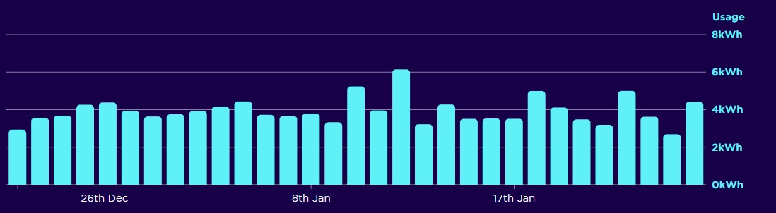

My daily grid use for the last month
. mine is 98% in the 8p window.
i totally agree with your sentiments on working the system..... i just do my normal daily thing, if it makes me money, then so be it, if it doesn't, then so be it...nothing lost, nothing gainedYour usage matches mine nearly to a T, must be a Welsh thing. mine is 98% in the 8p window.

When was it installed as surely at 5k the export prices weren't what they are today? Just curious as you're such a low user you're not the typical solar customer.not when your getting good export and only paid 5k for the solar..........and your system is sized to suit your needs. on Tuesday we only imported 2.7kwh from the grid, which is 88p say. I exported 9.1kwhs @15p = £1.25. In the the longer sunnier days we could be exporting 20kwhs+ quite easily, so 3 bucks a day and paying out even less than 2.7kwh as the sun comes up earlier and the kettle, toaster etc etc will probably run mostly off solar and the early office use.

it was installed in late October 2022, it was installed 21 days after i said yes to my installation company and octopus had already announced their new export rate of 15p before i pushed the button and as i was a customer i was able to get that rate as soon as i got my mpan number.When was it installed as surely at 5k the export prices weren't what they are today? Just curious as you're such a low user you're not the typical solar customer.
