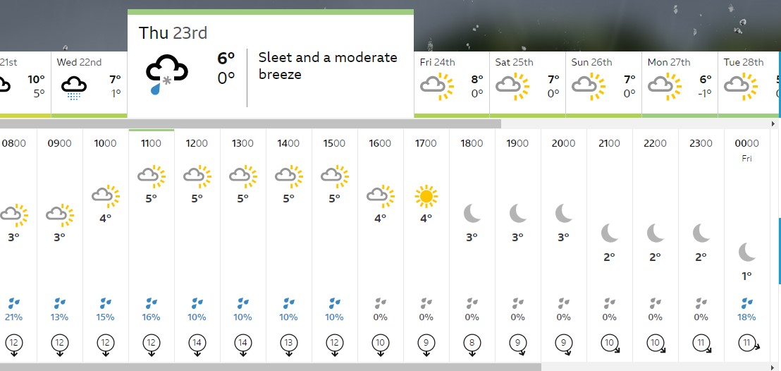

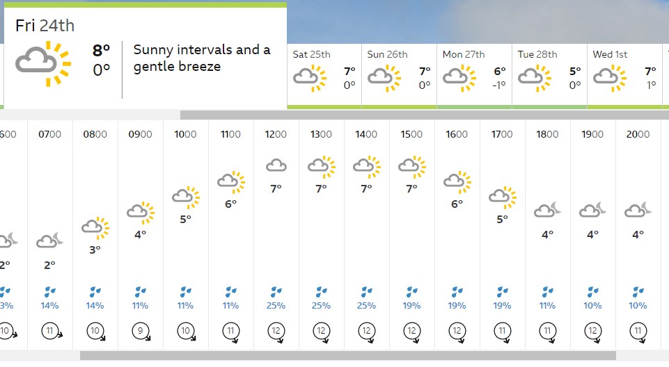

Heres to hoping this stretch of weather from thursday to next wednesday, brings the power. So far february has brought me 9 double figure production days.....maybe its not as wet in wales as we all think.
