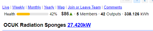

Guys we must have leapt up some places in the Table:

I'm uploading outputs data!

Can see we now have 6 in the team, just so you know you can upload cab files of past generation (200 lines limit). Just did this to day it was installed. If your on solaredge all you need to do is export the cab from the webpage & import. You may have to wait 4 minutes between each file but at least you don’t have to do it manually
@redfist Presume you mean CSV file, which you can export from the top right corner of the chart?
I have all of November showing now, and have now managed to join the team :D but I guess it will take a while for me to show up as a member.
