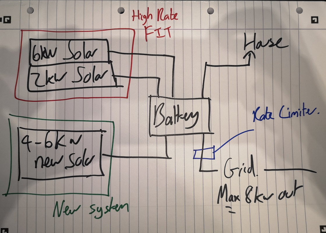

What im looking to do, but I dont know if this setup would be possible or if the tech is available to ensure a max 8kw is exported to the grid. I know rate limiting can be done from the inverters but theyll be the wrong side of the battery.
