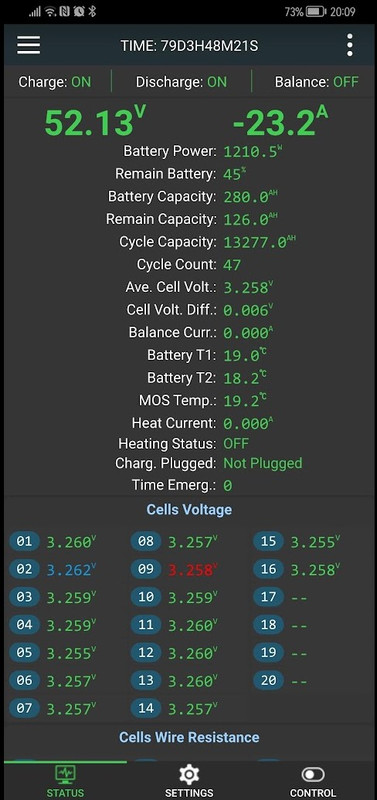

I can't help you but our of curiosity .. what is the state of health of the battery. it should be in your control software somewhere
after almost 2 years mine are at 95% with no noticeable drop in output.
attached are my details... SOC is charge, SOH is health at the bottom
@Mercenary Keyboard Warrior
It sounds to me like you may have a cell that's running away. Some BMS's (Battery Management System) are just plain weird in the way that they work. On my Victron system the shunt counts the amps in and out, it's the only way to do it reliably, but thats only if you use a shunt, but even this will go out over time, so you can set a voltage, a tail current and a duration, once all three are met the SOC resets to 100%. But if you connect batteries via Canbus then it relies upon the BMS to report the state of charge to the system, I highly suspect this is how yours will work.
Now a battery is made of individual cells, typically 16 cells, these cells can typically be between 2.5v and 3.65v, and they should never go under 2.5 or over 3.65. The BMS monitors the individual cell voltages, these may not charge evenly, and one cell could run away with its voltage rising quicker than the others, this normally happens near the maximum voltage, a good BMS will have balancing built in, but they only really work when the charge current is low, now if one cell reaches 3.65v (or the upper limit set in the BMS), the BMS will likely decide that the battery is full, and I think that is what's happening in yours. This may help you get an understanding. So you have a lot of cells that are not full, and one is, hence you don't store or get back the expected energy.
To prove this you need to find a way to see the individual cell voltages in each battery.
This is what mine look like, note the cell voltage difference is 0.006v, that's the maximum deviation between the lowest voltage and the highest, you need to see these voltages as the pack is charging, the higher the voltage the more likely they are to deviate, you would also need to know what voltages your cells are supposed to run at, but they should all be tight together.
Nothing I have found so far along those lines. To be honest I would not select Solax now as a manufacturer. I think their web/app stuff is really poor.

It won't be in any app, but you may be able to read it via a communication port on the battery, worth doing a bit of googling etc, it may be your only way to prove a faulty cell.
Actually just had a thought, if you have more than one battery, can you run with one disconnected, and see how it performs, then reconnect and disconnect another, and so on, it may help confirm which battery is faulty?
Generally you need to avoid the very low and very high cell voltages, as this stresses the cells, but it depends entirely on what they've set in the BMS and is a bit out of your control, but the lower voltages can be avoided by setting a higher minimum SOC.
Generally you need to avoid the very low and very high cell voltages, as this stresses the cells, but it depends entirely on what they've set in the BMS and is a bit out of control, but the lower voltages can be avoided by setting a higher minimum SOC.

They responded with SOC means state of charge.
They are mainly based in China and I think short staffed in the UK. (I have seen them advertise for support staff on Twitter)
I previously tried to engage with them as to why can I not find the option for the battery heating. They said its in the app, thats it.
Subsequently last week I think I have identified it is from a screenshot the installers sent, but it looks to me like the option is in the installer menu!
