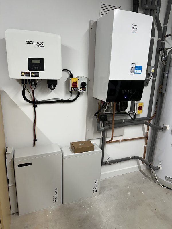

Battery and inverter installed finally:
However panels currently stacked in the middle of my garage due to high winds and amber weather warnings in my area again.
Think it will be into middle or end of next week looking at the forecast before they go up.
Both battery’s at 5.8kW, I assume one is larger than the other as it’s a main and the other a slave so some extra gubbins.
