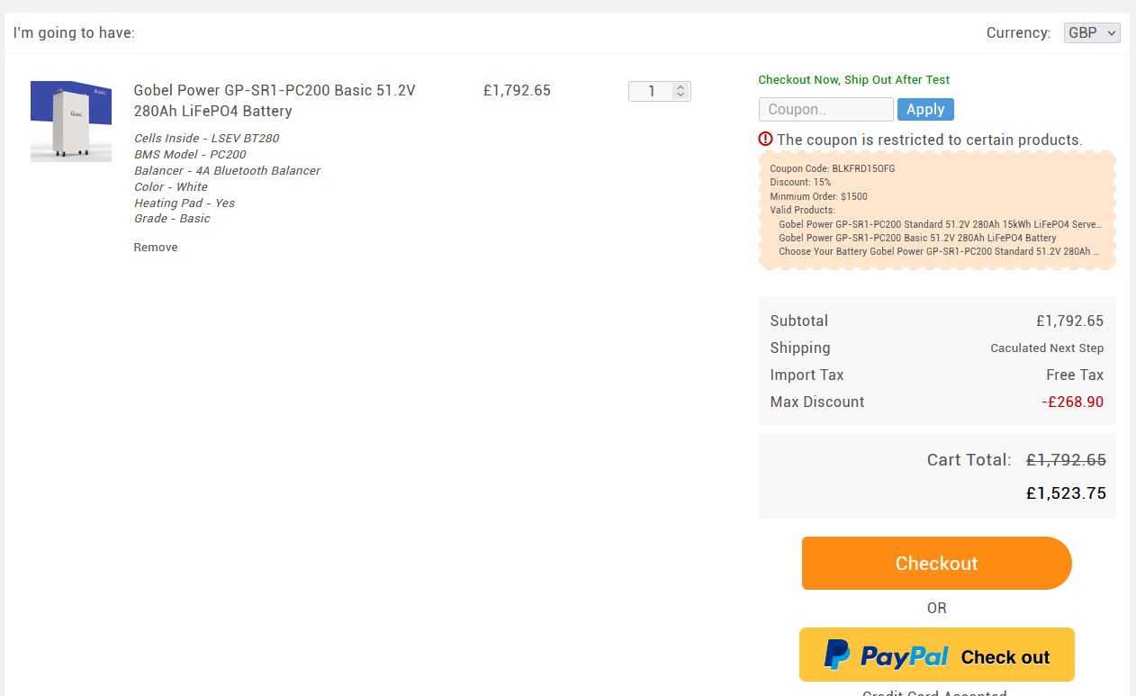

For twice the price of that battery you can get 15kWh battery, actually you can get a 15kWh battery for 50% more. If I was building my system again, I would certainly be using these Gobel Power prebuilt batteries, Andy's off grid garage Youtube channel ranks them highly.
or even better ready assembled with decent balancer for £2500 after discount.
Or even cheaper at £1532
