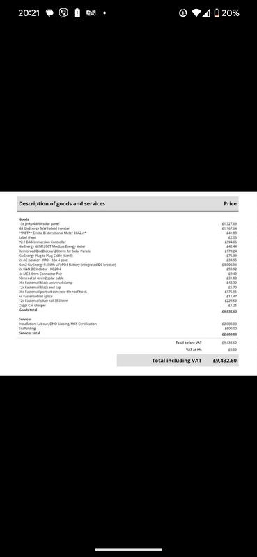

This is one over on Facebook for comparison:
It's amazing how much they add to the prices, you can pick up the Gen3 5kW inverter and a 9.5kWh battery for £3,195 as Joe Punter so they are adding serious margin to the kit to make the install look cheap, same for the panels, if they aren't the all black NEO panels and just the standard 440w (which seems likely) they are £75 each. Unless they are spreading the cost of the Zappi Car charger across the other parts, which seems to be listed at £1.25, which seems odd.
