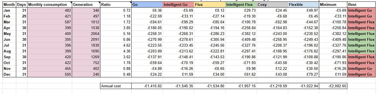

Now that's making my head hurt, I've not updated all the prices for the respective tariffs as they do differ slightly from what I would be charged here, but the spreadsheet is saying -£137 for Flux for the year and all the rest including Flexible are -£1000 to -£1500. I'll have to do some more digging, but something seems off. Actually just noticed the best strategy for Flux hasn't yet been implemented in the spreadsheet, perhaps thats why.
Replying to myself here, but the issue was my huge predicted generation broke the spreadsheet :cry: Now he's fixed it, it looks more correct now.
Flux appears to be pretty good, not the best, but still good, especially as I don't have an EV or heat pump yet.
It's nuts that you can still be have a negative cost in November and February on Go :D
EV and heat pump will change the game, particularly the EV which will nerf a lot of Flux/Intel Flux gains in summer.
