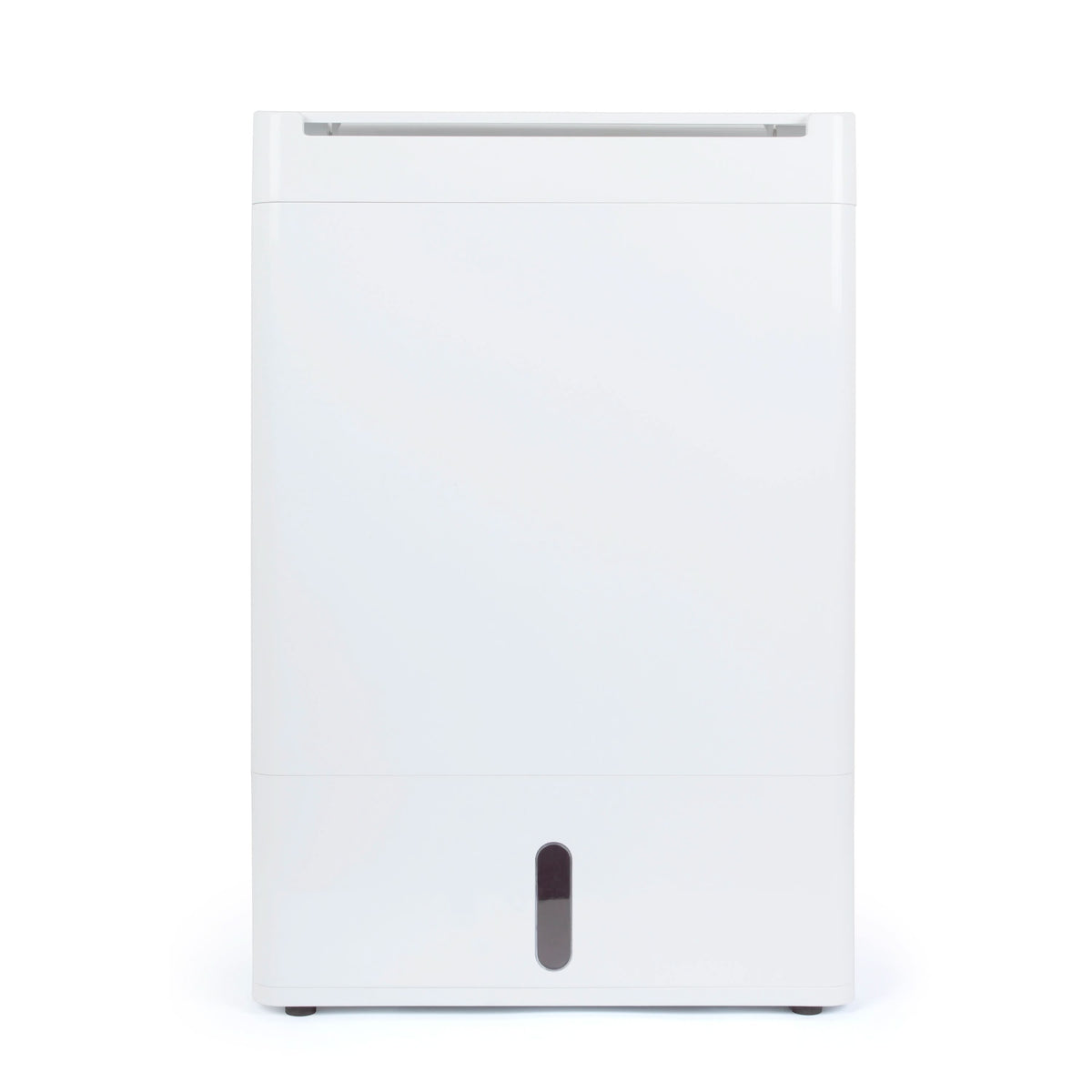

The new meaco 2 has app control for timer functions.
I think it was the big thing missing from the meaco one. And they have this warning against switching the unit on and off via the plug socket for some reason which means you can't use a smart plug.
Does that include start time then? Currently considering options for clothes drying - the current (very old) dehumidifier we have to dry clothes can't be started by timer/smart plug, but does have a run-time timer. We need to be able to start it at 0030 and end it at 0530 to use the Octopus GO cheap times.
Sorry I don't know, don't have one myself. @Feek just bought one - how's the app work?
There's a timer so you can set it to start in xx hours and end in yy hours but you can't specify actual times.

Had nothing but trouble with our Meaco DD8L Zambezi Dehumidifier, noisy, always throwing C errors when using the drying function. contacted them serveral times and they just gave us useless info, ie vac the filter turn it off for 30 mins etc... just don't!
How long can i expect a meaco dehumidifier to last? i got the premium one instead of arete not knowing the warranty is 2 years instead of 5 and now im worried and if i return it because ive used it i'll only get a partial return
Several months ago I ordered a Meaco Arete Two 20L but received a 25L instead... !!!
It's certainly effective and we empty the 4.8L tank virtually every 24 hours. However I wouldn't described it as "whisper quiet" like Meaco do on their website. It's more like "a very noisy fridge" but fortunately it lives in our basement hall so that's not much of an issue.
The app is generally fine and I created a schedule to switch the device on in the morning and off in the evening before bedtime.
The humidity sensor reads 8% lower than my Thermpro TP50 monitor but I have no idea which device is the most accurate as neither device make any claims to having been calibrated. (calibrated sensors are generally a lot more expensive).
Unfortunately it's just started to throw an L2 error and then switching off (which is apparently motor related) so I need to get onto Meaco about this.
