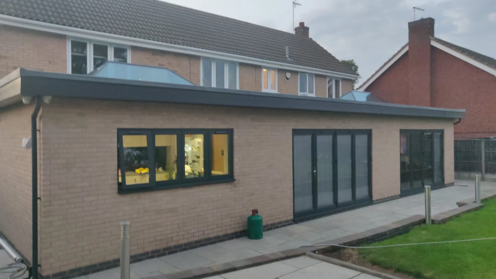

Hello chaps. After some split system guidance.
Here is the room
Naturally, it gets too hot even on a slightly sunny day and it was a massive mistake not having it fitted when it was built, but anyway...
I am obtaining a few quotes from local people, but can anyone give any pointers roughly how much "power" I should be looking for?
The room is 14X4.8metres, 2.8m ceiling. There are two roof 'lanterns', 2 sets of bifold doors and 1 window so plenty of direct sunlight. The first chap I asked has recommended 2x split 6kW systems which seems like a hell of a lot for one room, but is that in the ball park I should be looking at?
£3400 excl. VAT fitted, with the sparky for us to sort.
@ShivP have you thought about solar film on all of your panes of glass? I had a local firm quote me £150 all in for a patio door half your size and a window half your size too. Mind you, that would probably mean about £1000 for all of yours with your lanterns too. It could reduce the amount of cooling you would need.
I couldn't answer what size kw units you would need. I think 2x 6kW seems excessive but perhaps its due to all the glass!
P.S lovely looking living area and kitchen you have there :)
I believe the lanterns have solar film pre installed however not thought about the doors and windows yet so thanks I will look into that. The doors have integral blinds though so do you think it would help in that case?
Thank you, that is an old photo inside, it looks less 'showhome' now but couldn't be bothered to take a new one!!
