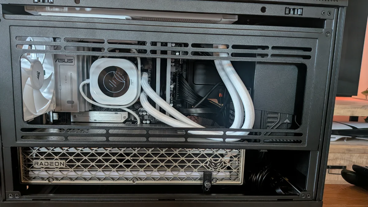

Not got steam os on it yet, just windows and game pass. Thing is so quiet, and I only have two fans. So far CPU and GPU not been above 60 degrees.

Looks great ! Have been considering building my own "Steam Machine" over the last year or so to replace my PS5 Pro for gaming in the living room. How easy was it to install SteamOS ? I presume this build came without any OS pre-installed ?

Should have done this earlier, not installed steam os yet as want gamepass so will make the switch when I can be bothered rebuilding it all again, might wait until I have a spare SSD just for it. Plays everything lovely and despite me having to remove one fan from the AIO as it wouldn't fit over my RAM, the thing is super cool. CPU and GPu both never above 60 so far in testing. I will set an undervolt on CPU when I can be bothered with the whole stability testing malarky. Plague tail resonance, BF 6 and subnautica 2 play incredibly well though and windows cotroller support is far better than I had imagined. No worries now on Sonys no physical bull**** I can just wait for steam sales :-)
Gave mine a proper work out with games this weekend, cant believe how quiet the 9070 non XT and 7800X3D are with the minimal cooling I have, can't hear anything even when BF6 is running. Can honestly see me putting an RDNA 5 card in this box before my desktop.
Subnautia 2 at 4k on my couch is the perfect way to relax :-)

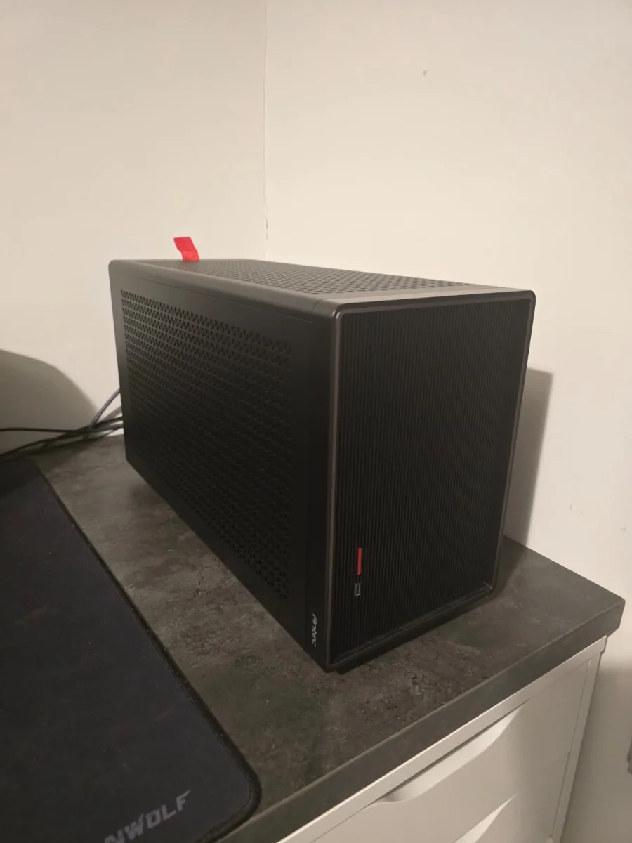

Built my recent pc using a really cheap case that cost me £50 new (was like 200 when it came out a year ago)
Antec Performance 1M, spec is pretty decent, AM5 7950X3D, 32gb DDR5, 5070ti
Runs like an absolute dream, like a slightly bigger and faster Steam Machine that's still ultra portable.
I have been looking at the M1 case recently for a new build. Can I ask what CPU cooler are you using?
Yea sure it's the Thermalright AXP120-X67
Works really well tbh - I have a slim line 5070ti so I had a decent amount of space on the cpu side so it's not right up against the side panel
That's good to know, I think that's the cooler I've purchased but only using it for a 7700 for now. I bought it for down the line when switching out CPUs
