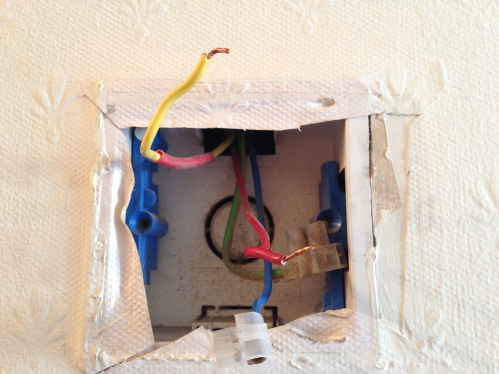

Here are my install pics:
Old thermostat.
Existing Wiring.
Wires removed.
Tado support confirmed how I should wire it up.
