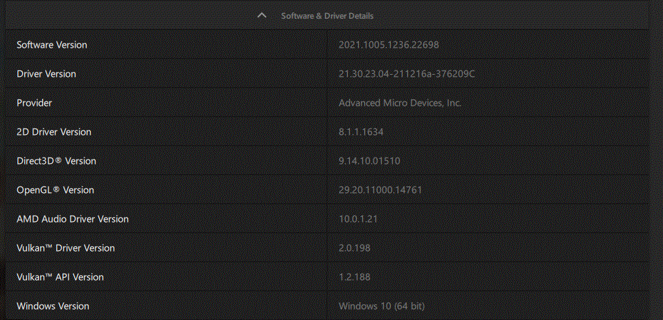

Weird question perhaps but I can't figure out which driver I presently using. Can't make heads or tails of the Driver Version but the Software Version seems to be closer named like the driver downloads. So if that is right, then if I'm reading it right it is 2021.10.5 but I do not have such a driver downloaded. Have a 2021.10.4 though.
And yes I know, should upgrade but it been working so not been bothered with is, still working but since I started gaming a bit more again thought I update them. Just wanted to know which driver I actually using presently incase it goes pear shaped for me. :o

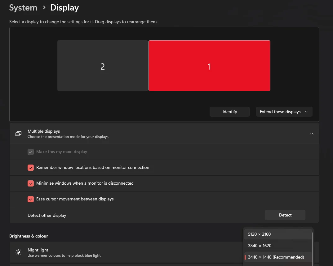

LG 38GN950-B, 38" 3840x1600, Nano IPS, Freesync Premium Pro, Don't see the option anywhere to enable VSR.
In AMD Software, go to Settings -> Display and turn on Virtual Super Resolution, then you can increase the resolution in Windows -> Settings -> Display
