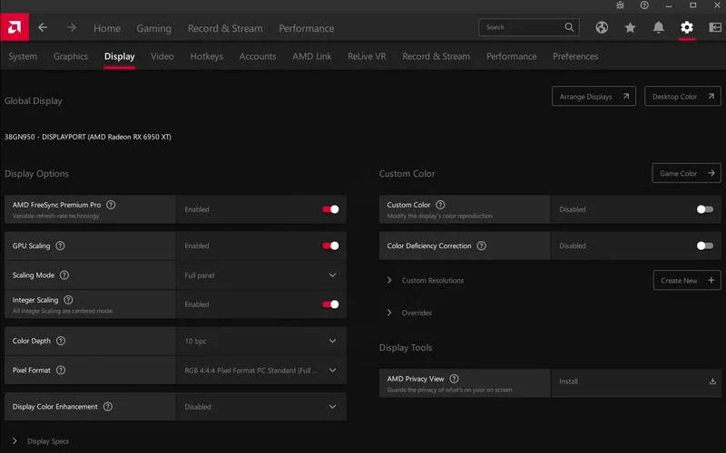

Appreciate the reply but what I'm trying to convey is the option to enable VSR is simply not there, Everything else is i.e enable Freesync etc... but not VSR.

Also note that the GN has a quite odd resolution of 3840x1600 so may not have been accounted for by AMD due its rarity.

Maybe its a DP thing, are u using hdmi? Or maybe its the cable thats making it not show, can u show a screenshot of ur display window in amd sw?
Using display port, Also tried a few different cables just to see if it's hardware related and it's not, Here's the screenshot, As you can see VSR is simply missing -
Could it be resolution related, like @JediFragger suggested? Reason I say that is that your screen is 3840x1600, but the screenshot @AMD_Vik shows a resution of 3840x1620?
Appreciate its unlikely, but perhaps its not giving the option due to the mismatch?
Could be but until, IF, An AMD software person looks into it we won't know.
turn off gpu scaling, might work then. Maybe integer scaling too?
If gpu scaling off doesnt work right away try rebooting then if still doesnt work, try keeping it off then go to system/factory reset and reboot.
Failing this check if ur refresh rate is the problem, i think u have 144 but it can overdrive to 160. Try 120/144, if using 160.
Appreciate it but I've tried all of that, Nothing works, I think this is just a matter of AMD not supporting this resolution which is a little sad considering an RTX 2070 I tried a bit back supported it no problem, You'd think with their current top of the line GPU VSR would be supported at any resolution.

Dont suppose adding a custom res using override option to get a more standardized res near ur res might help to trick it to show vsr option?

I've used both AMD's method and eventually DDU, Also tried the custom res option, VSR still doesn't show up, I think it's simply down to VSR not being compatible with my native res.

I know it's a very niche monitor resolution but is there any chance you could nudge your driver peeps to add the res of 3840x1600 to the supported resolutions for virtual super resolution pretty please ? With Nvidia I am able to use DSR and have all types of much higher resolutions on my 3840x1600 display, Very useful for much older titles and getting rid of aliasing, Would be nice to be able to do the same with my 6950XT :)
