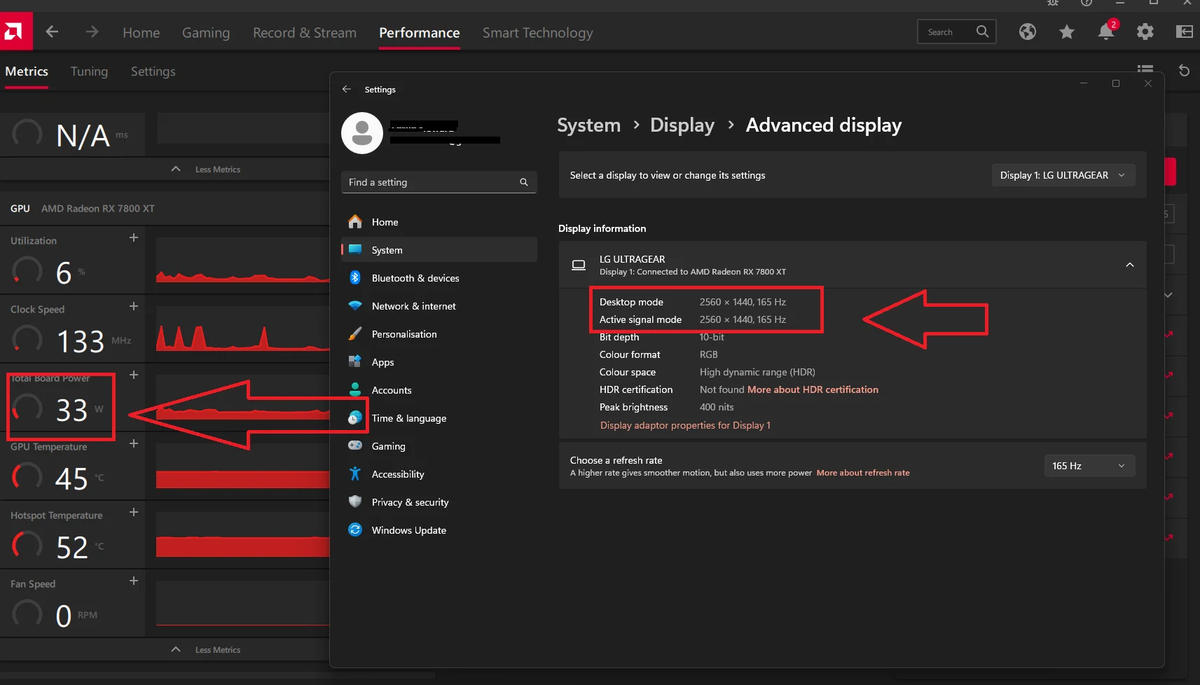

Since issues posted in this thread seem to get earnest attention from AMD, I'd like to mention idle power consumption again. It had been at high-but-bearable levels up to driver version 24.4.1, with the overlay showing GPU BRD PWR of about 60W when just sitting at the desktop. Version 24.5.1 increased that to a ridiculous 100W. 24.6.1 behaves the same as 24.5.1.
I can reduce it back down to 60W by setting my primary monitor to 120Hz instead of the full 165Hz. If I also disable HDR on my primary monitor then it goes down to a much more reasonable 35W.

I think it's the combination of multiple displays with at least one having a high refresh rate; maybe something to do with the total bandwidth required, given that HDR affects it too. Just having two monitors is fine, as long as they are both 60Hz.
Its a multiple monitor and hi refresh issue, something to do with the gpu ram needing a more juice I think. I was mostly fixed but certain combinations need to still cause excessively high usage.
I only use one monitor but my previous screen was 144hz and would use ~15w. New monitor is 360hz and uses and ~35w idle
Desktop power draw has still been wonky, but improved after installing latest driver and doing a CRU reset.
