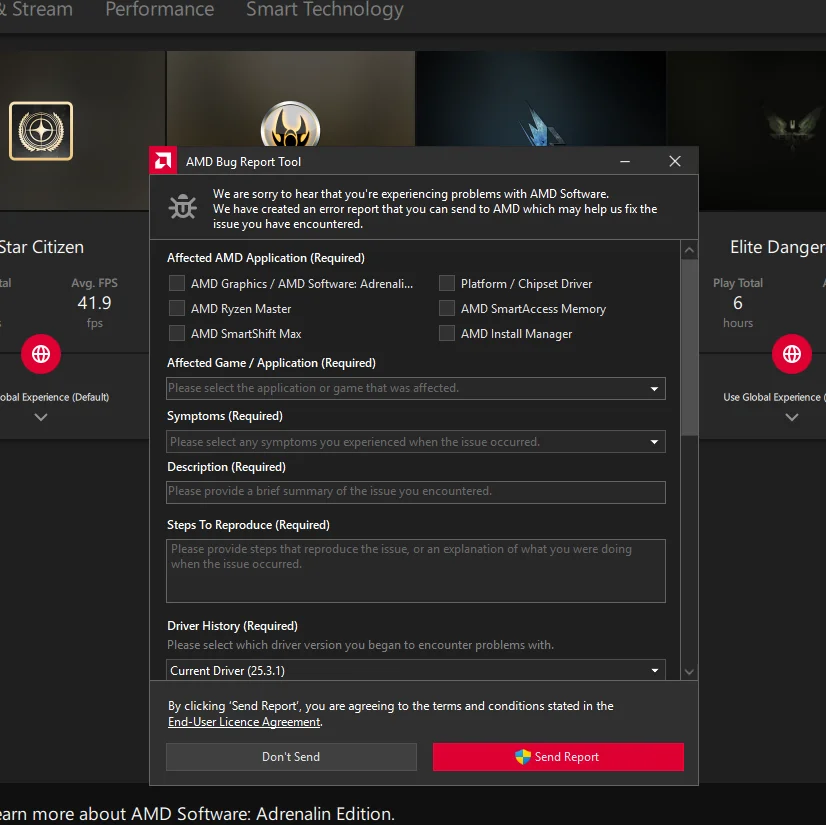

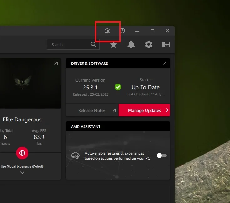

Also... you cann report bugs, its probably the best way to let AMD know.

@AMD_Vik Is this anything AMD is aware of? or do I need to submit a bug report?

I haven't tested with firefox but all chromium based browsers like Edge, Brave and Chrome does it unless I change the backend to DX9 or turn off Freesync. Also the screen turns off and on rapidly once if you switch Freesync on or off. It didn't do this with my old 6950XT which makes me believe that Freesync or something connected to it that is at the center of this problem. I've already submitted a bug report through the driver.

Will report bug in Adrenaline and Chrome
