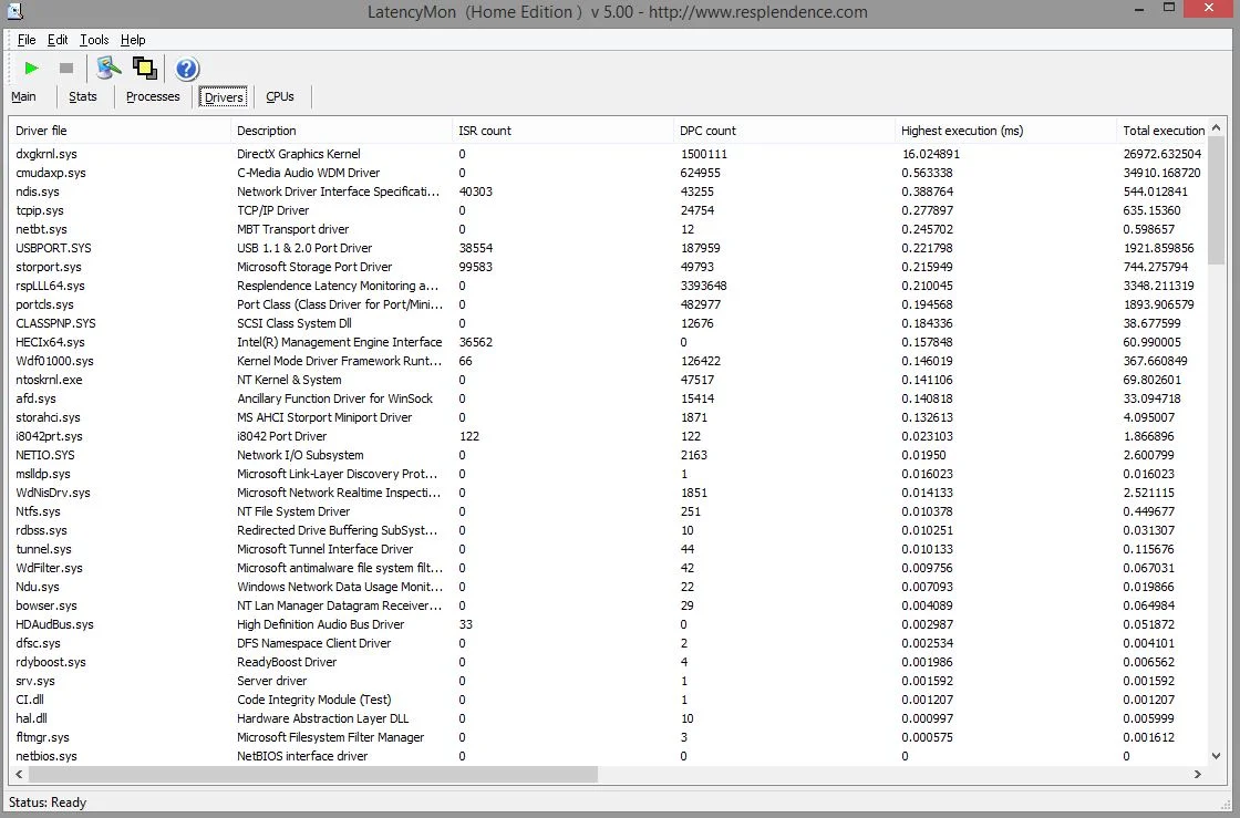

I'd settle for them fixing the DPC latency I'm getting with xfire, never mind xfire performance with games. I mean look at this :(

Ah interesting. But that was a single card right? My problems only appear in crossfire and with my second monitor enabled. If I disable my 2nd screen everything is perfect.

What you getting DX high spikes is what I was getting..

Tested after swapping the cards: single card is still fine, xfire is still a problem. Problem still disappears after disabling my second monitor. :(

What connections are you using? Not that it should really matter tbh...
HDMI + DVI to HDMI here for my two screens and no issues fwiw.
Yeah I was considering that myself. I'm using DP for my primary and hdmi to my secondary. That only has hdmi and analogue so I might borrow my gf's secondary to see if dvi changes anything. The thing is I'm not the only one having this exact same issue. There is a guy with 4 screens and if he has 3 in eyefinity and the fourth not, DPC goes through the roof. If he disables the fourth it is fine. 3 screens and no eyefinity, DPC through the roof. If he disables all but the gaming screen it's fine. Seems like a very specific issue to me.

Update: tried a different DVI monitor and after a brief moment of hope realised I had enabled crossfire. Same problem sadly.
