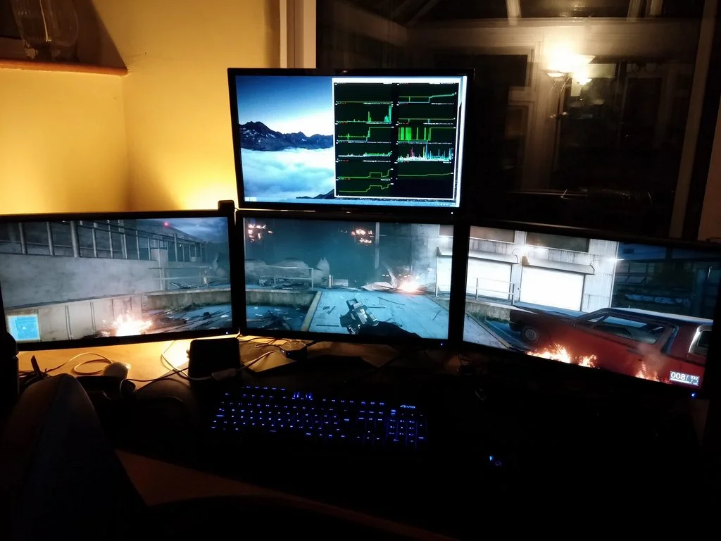

Having a 4th screen works very well with Eyefinity - when you set up an Eyefinity Group, you simply select 3x1 as the configuration and then select which 3 you want in the Group. The 4th one can then be added as an Extended desktop monitor so Windows "sees" 2 x monitors attached (one at 5760x1080 or whatever, and one at 1920x1080). I have Afterburner's OSD running on my fourth monitor while playing games on the main 3.
The issues I found were in some games having issues recognising how your system is set up - in LA Noire, the game went to Vert- where it should detect an Eyefinity setup automatically, and Alien Isolation wouldn't display any menu when started up. I moved my fourth monitor from the GPU onto the Intel onboard graphics, and both game issues were fixed next time I ran them. This is why my "extra" monitor is run from the onboard - I simply found this less problematic in some games than I did when the GPU was powering it.

Is that a stand you can buy for 4 monitors or did you have to make something up?

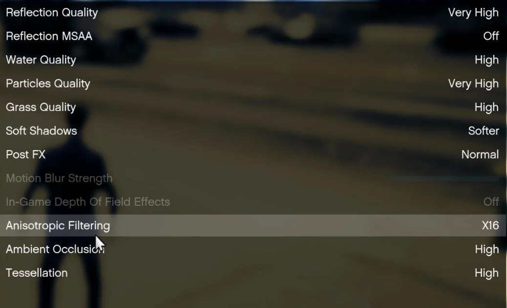

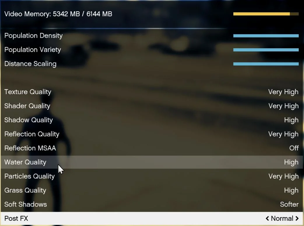

These are my go to settings currently, that offer the minimum amount of stutter. There is a little bit every now and then while driving, game bug it seems, but on the whole it's very smooth.
I have plenty of grunt spare to run higher settings, but i found this mix to work best for me at the moment until future game patches come out.
Tessellation is set to very high.
The above settings offer me 60FPS locked Vsync, with gpu usage around 50-60% per gpu.
just tried your settings and just had to adjust
Reflection quality to very high
soft shadows to softer (can't really tell the difference anyway)
post FX to very high.
It's actually a six-monitor stand I bought from a competitor a couple of years back, I simply didn't bother adding the two arms for the top monitors. It was the cheapest stand I could find that would allow my monitors in the configuration I wanted, and I've been vey happy with it, although if I was constantly fiddling with the monitors I think I'd want something with a little less "give". That said, once you've got everything aligned, it's sturdy enough that it's not going anywhere, it's just a case of putting something half a centimetre further than you want it so when you let go it drops to where you want it, if that makes sense.
It was model number "NOV-MSSEX2" when I bought it, but it seems to go by some other model numbers too at different places - "AT 1339AT", "TS746A", "TS746E". A quick Google hasn't thrown up anywhere still selling them, unfortunately.

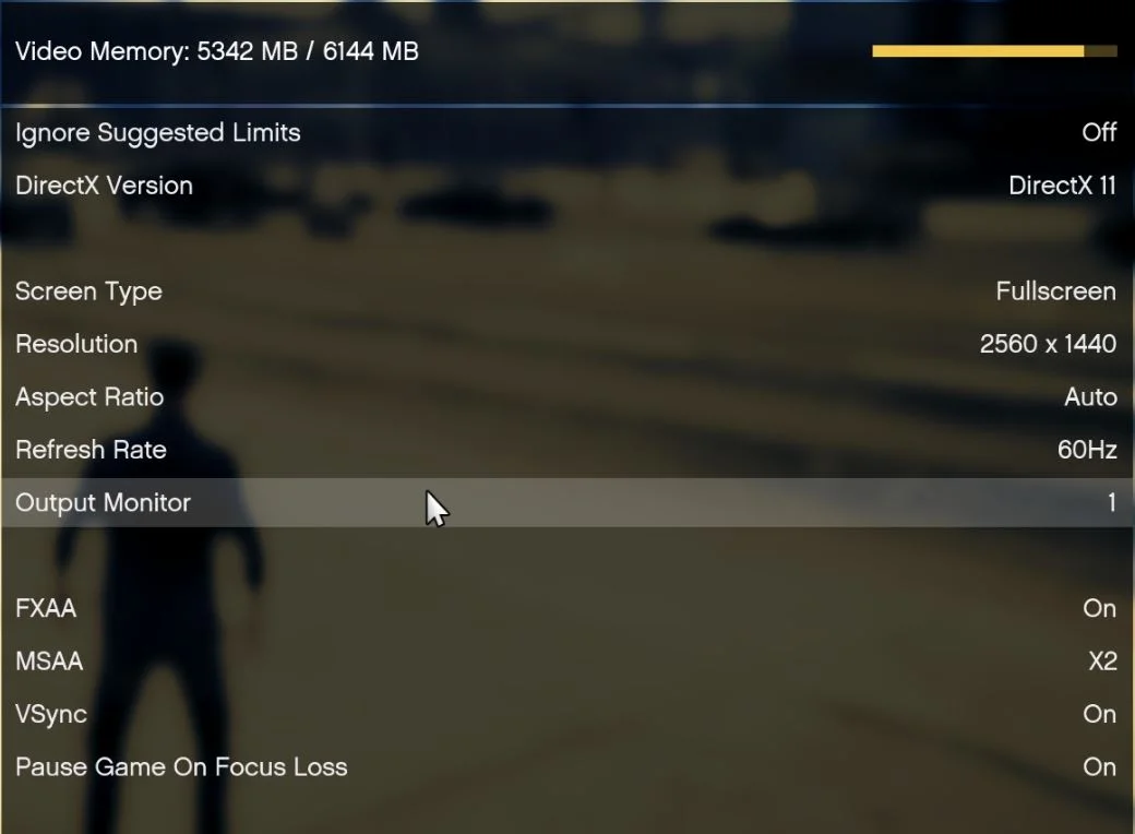

Just played GTA V and i'm only getting about 60% GPU usage on both cards and i'm just wondering if thats normal? I have it FPS locked to 57 in Riva Tuner Stat Server after reading that it can help a little with stuttering.
FPS is pretty good and mostly stays above 50 with momentary drops to low 40s when driving. The settings i'm using are in the screenshots below.
All advanced gfx settings are set to 'Off'.
Thanks
Yeh if u have ur fos locked thats all the gpu power its needing to get that fps.
If u turn the fps lock off u will see it go up.
Not sure that's true. I have 2 x 280x and run at 1920 x 1200....whatever settings in use in the game GPU useage never goes over 60% per card yet the fps doesn't improve. I just think that 280x xfire is inherently crap, so many issues.
I have to unplug my second monitor when gaming to reduce the stutter, unacceptable tbh
if it doesn't change could be 1 of two things.
1) really bad xfire drivers
2) Bottlenecked by your CPU.
If its GTA V its not the xfire drivers as my 290X crossfire uses 100% on both cards.
