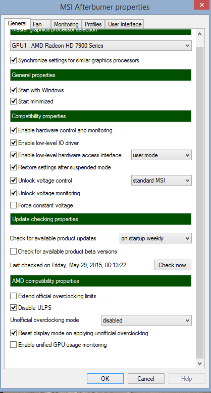

These are my settings

It looks like it is the afterburner monitoring that may be causing my stuttering, if I pause it then the games are fine.

Interesting. Try enabling Unified Gpu Usage Monitoring, or try increasing the monitoring time to 3,000. Or perhaps you're trying to monitor too many things at once, try removing some.
Should I disable ULPS in MSI AB matt? Does it offer any improvement in game performance?
