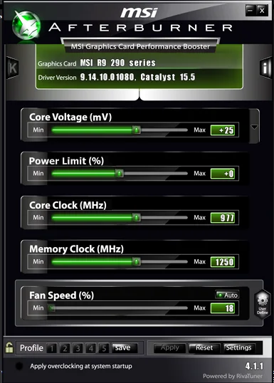

TBH, I could do with dropping the temp of my msi 290 twin frzr 3 card by a bit! Any ideas what I should set first?
At stock, -25 should be ok. If not, up it a little. You should at the very least get away with -12 at stock clocks.
Check the ASIC rating of the GPU. Higher ASICs should be stable on lower volts.
That is a great ASIC rating, suggesting decent power efficiency of the card components.
You should be able to go -25 at least. Temperatures should also drop a few degrees.
Also remember to up the Power Limit to +25, which appears to help with black screen issues.

Oh nice, seems I got a good 290 then :D
Thanks for the advice again, I will jump on for some GTA 5 now, monitor temps, then try those settings and jump back on and see what the new temps are like, shall report back soon! :)
