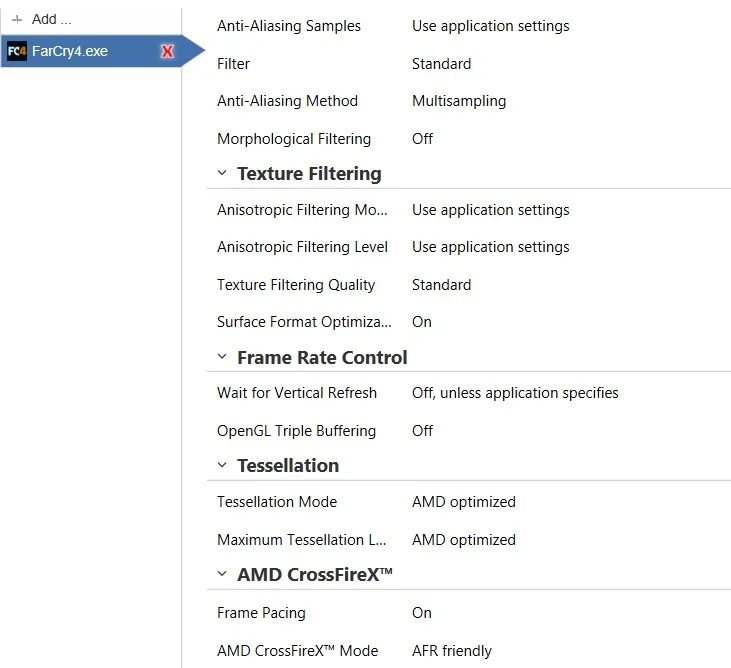

CCC>Gaming>3D Application Settings>Add game profile>Browse to the FC4.exe and click it>Select FC4 and pick 'AFR Friendly' in the AMD CrossFireX Mode.

this is not a driver fault.
You sure, Ryse done the exact same running AFR/C3 profile(iirc) using MSAA before an official profile came out, not tried it since as I finished it.
Soft shadows, hdbo+ and light one forget it's name.
Out them only soft shadows shows big difference in quality but performance is massive hit.
Okay thanks, I'll check them out.
I figured out the problem, the start of the game is locked to 60 fps. :D
Progressed a bit further and bam, 95% Crossfire scaling in QuadFire at 4k.
Also there are some bugs with MSAA and SMAA in this game. If you look at this users video, i get the same issue when i use SMAA. I think it might need a game patch to correct the issue, this is not a driver fault. :)

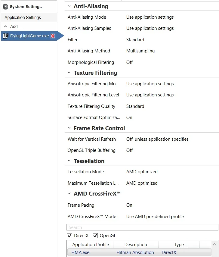

Got around to trying Dying Light on 14.12.
Found either Hitman Absolution or 1x1 Optimize custom Crossfire profiles seem to work flawlessly with all settings maxed out and vsync on. :)
Tested at 1440P on a single 295x2.
