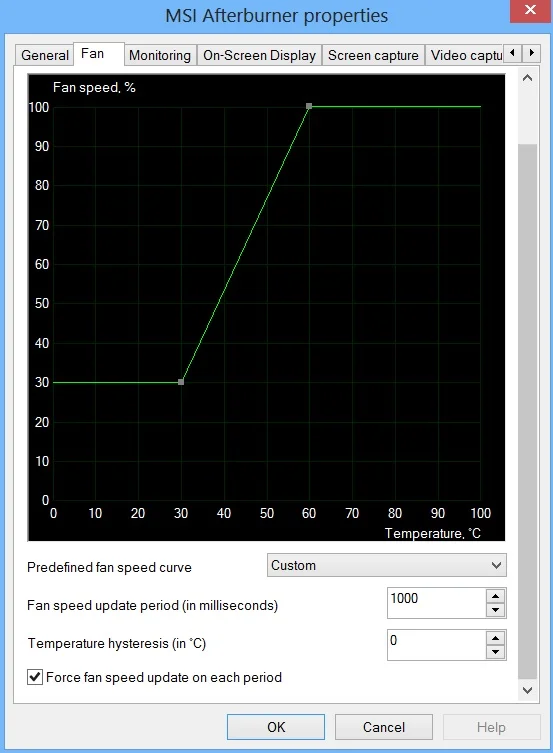

If the computer is in 2D mode this is normal if you have ULPS enabled, the second gpu literally turns itself off including the fans.
Disable ULPS in afterburner restart and the fans will start spinning, slowly at idle.
that sorted that problem -) i can control my fans now, if i have upls enabled will my customer fan profile kick in during gaming?

Yes your custom fan profile in afterburner should work fine, these are the settings i used to use on an older gpu. :)
