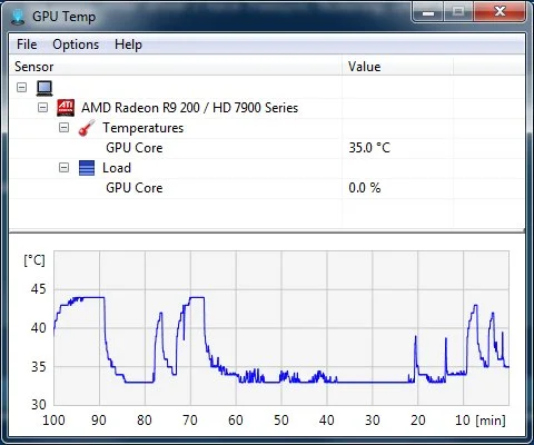

I accepted an upgrade to 16.7.3 earlier this week and have noticed my fan speeds and idle temperature have increased as well as other random stuttering and hesitation when working within Windows. I've not even tried gaming.
GPUTemp looks like this, previously temperatures were very stable.
What's going on?
From looking back in my driver library, I think I was on 16.4 previously.

Watching youtube / twitch / streaming video? My card (290x) comes up from 30c idle to 40c - 45c for that load.
Don't have an issue with stutter or fan speeds though. Fan speeds could be down to a different fan curve in vbios.

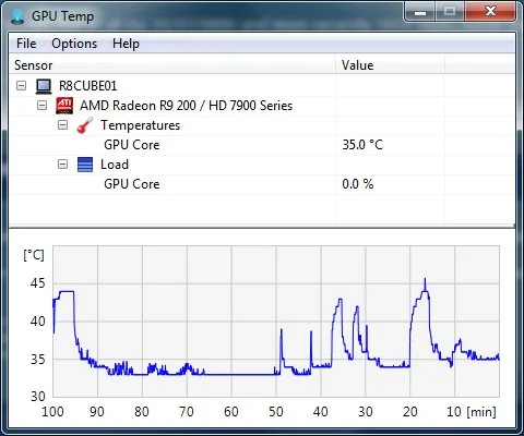

I can be sat on OcUK and glance down at GPUTemp and it's at 45º (up from 36 idle)
Youtube only increases it by 1-2ºc
It's definitely only been doing this recently, I would have noticed much much earlier otherwise.
Last 10 minutes of this GPUTemp graph are watching a Youtube clip
shankly1985, I did think about that, but nothing has changed on my machine apart from these drivers... so basically, why should I? Is it good practice to do this as a normal 'tweak'?

Any other clue to resolve the flickering issue other than go and buy a 1080 or a Titan?
Disable hardware acceleration in the browser you using?
Shankly you absolute gem.
Twitch, youtube, and even ******* facebook have been making my PC turn into a leafblower for the last 2 years. I've googled it and found nothing, and then you come along, like a bloody white knight, with the solution.
Legend.
